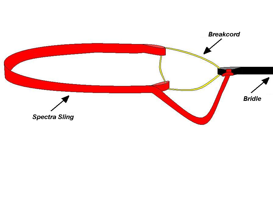

DexterBase 1 #35 June 29, 2003 Hey 689, I went back to the proverbial drawing board and this is what I came up with. It's super clean but would require a rigger to construct it. I like it, let me know what you think... Share this post Link to post Share on other sites

DexterBase 1 #37 June 29, 2003 The breakcord is the weak link in the system and you want to protect it from the object itself. You need the breakcord to part at 80 pounds to ensure a safe deployment. If you're on a low jump and the breakcord parts before the canopy is at line stretch (or even extracted........ chills...) you're done. If you loop the breakcord over a handrail with a sharp edge or a piece of angle iron, your static line could break at a much lower tension. Share this post Link to post Share on other sites

sum1sneaky 0 #39 June 30, 2003 QuoteI don't see how gemini cord would offer any advantage over a spectra sling. The thought I had - which I didn't really explain - is now absolved by your latest drawing, at least during the breaking of the break cord stage, by the lack of the pulley effect - in the older version, the stiffness of the gemini cord would help it to experience a lower coefficient of friction when coming around the object, at least less than a spectra sling. the spectra is so supple, that it likes to create sharper angles than something that cannot be bent upon itself as easily. It also has more small pile like fibers that will interact with small irregularities of the object causing higher friction coefficient as well. gemini cord has edge cut resistance far superior to spectra - so that was one more thought on how it has less friction around the point. however, i agree about the knot being super snaggy... that would certainly suck to be left hanging there! Maybe the know could be minimized to a water knot and hid inside the bridle attachment point... but this would be only for the first drawing. For the second drawing, it would be much more difficult to construct gemini cord... and I think this latest drawing looks like a much better system. In the modified drawing, the friction factor doesn't need to be considered until after the break cord has broken - at which point you just have to worry about the bar tacks snagging the object attachment point - or, I guess, rig it in a loop to avoid the blocky bar tack. Another option might be to use dacron or some sort of kelvar kite line that can be fingertrapped and sewn closed - much like toggle settings etc... - this might help create more snag-proof loops like you'll need for the latest design. Good thoughts dexter, Cheers! Share this post Link to post Share on other sites
base689 0 #40 June 30, 2003 > Hey 689, I went back to the proverbial drawing board and this is what I came up with. It's super clean but would require a rigger to construct it. I like it, let me know what you think... It is a very good design indeed. I really like it. Provided there is ENOUGH slack for the "fixed" part of sling (to bridle) with respect to break cord loop, that in this case is going to break at 80 lb - 36 kg. The other remark I would like to point out is that, once on the object/handrail/fixed point on structure/whatever, you must do a good thinking about the "free" end of spectra sling that, after break cord failure, is going to pass around "fixed point". This "free end" is going to pass around "fixed point" and clear itself with a whip stroke, so you must be absolutely sure that with such a whip stroke it DOES NOT touch any other part of structure, possibly hanging up/entangling anywhere (but this possibility exists with ANY design involving taking with you break cord/static line). One very last remark: why use (exclusively) spectra sling? What about using 5.5 mm - 1800 kg dyneema climbing rope? Or similar rope? The loops, in this case, can be made with suitable knots, even if a rigger with proper sewings could do a cleaner job. Still being very careful about knots/thickenings (because of sewing) on the "static line" NOT hanging/entangling anywhere because of the whip stoke. My compliments indeed, Dexter, I think your design, with possibly small modifications/personalizations, could be the set up to go!!!! Stay safe out there Blue Skies and Soft Walls BASE #689 - base_689AT_NO_123_SPAMyahoo.com Share this post Link to post Share on other sites

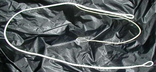

Hooknswoop 19 #46 July 8, 2003 This what you were thinking of? Dacron and 1000 lb Vectran. Hook Share this post Link to post Share on other sites
DexterBase 1 #47 July 9, 2003 That's awesome! Wanna sell me one? Share this post Link to post Share on other sites
base689 0 #48 July 10, 2003 It's a fantastic set up, Hooknswoop!!!!! Not to put your idea/work down, but the only downside of your sling is that, being made from dacron/spectra parachute line, yes, it is very robust but it is NOT abrasion resistant. And, being so small and NOT abrasion resistant, I see that thing not working very well in a set up where the handrail/whatever is sharp/sharp edge/small metallic protrusion popping out of surface/whatever. In the long/medium term, the dacron/spectra sling is going to have a smaller section due to abrasion suffered with contact with metallic surfaces. My small contribution: why don't you manufacture EXACTLY the same set up but using a, let's say, 4 mm dyneema climbing rope? It's got a 750 kg - 1653 lb Break Load, and, more important than that, its sheath is MADE FOR resisting to abrasion (being made for the alpine environment to be dragged around all over the rocks). I already manufactured "your thing" using such a 4 mm dyneema rope, presently creating the 3 loops with knots (not jumped, ...yet...). Yes, indeed, it is a much smarter idea to have the 3 loops sewn by a rigger using inserts and whatever, so having a much thinner appearance. I shall try to have it done more properly by a rigger. I shall let you know.Stay safe out there Blue Skies and Soft Walls BASE #689 - base_689AT_NO_123_SPAMyahoo.com Share this post Link to post Share on other sites
