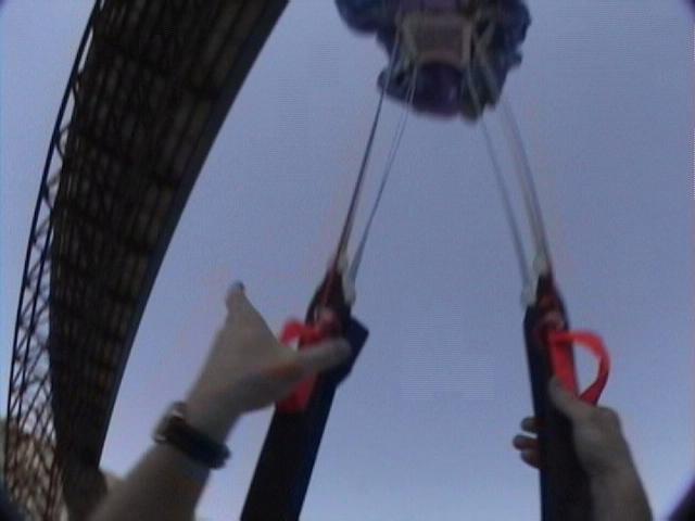

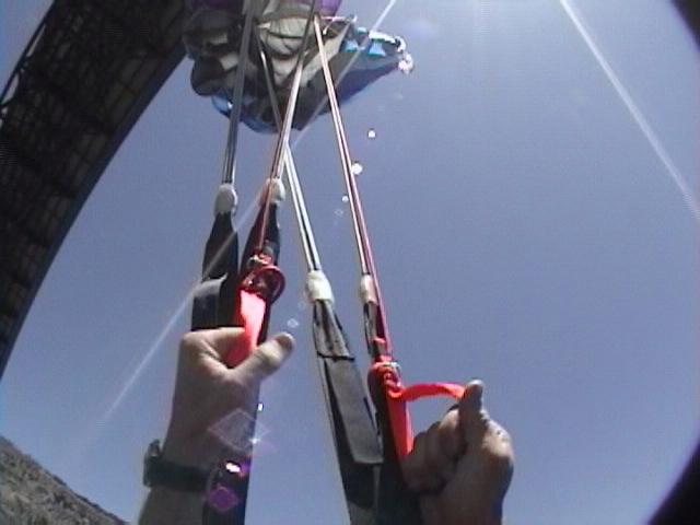

Option: Big Grab Toggles
I recommend beginners get stiffened toggles. You loose height under canopy with the brakes set much faster than when the brakes are released and the canopy is flying. It is common to see a beginner (and sometimes experienced jumpers) fumbling to grab the toggles after opening.
Stiffened toggles do not require any additional skill to use, they just lower the chance that you will fumble for the toggles and loose valuable altitude in the process. Fumbling for a toggle resulted in a wall strike and severe near-fatal injuries of a jumper with 1,273 BASE jumps. Stiffened toggles may have (by the jumpers own admission) prevented this accident.
See attached photo's of the big grabs in use (plus a 5 year old skysurfing photo thrown in for the hell of it).
