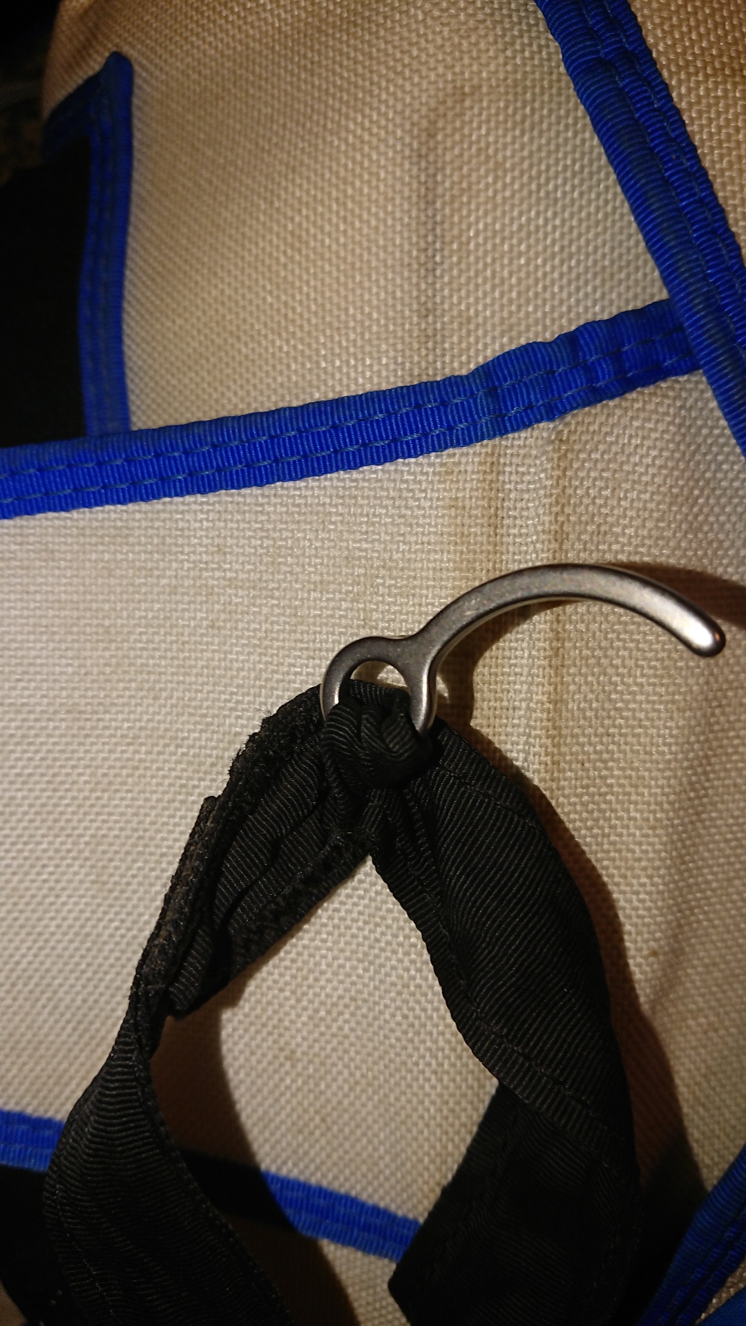

mathrick 2 #23 March 20, 2018 lyosha***Kill-line window is not visible. This depends on manufacturer. https://www.facebook.com/TheRanchPROshop/videos/1798144140209450/ It doesn't. My bridle is of the "old" style (albeit without any velcro), and all it takes is a little care and thinking things through to expose the kill-line window. Just bend the bridle the other way, with the pin on the inside of the bend. I can post pictures later if it's at all unclear."Skydivers are highly emotional people. They get all excited about their magical black box full of mysterious life saving forces." Quote Share this post Link to post Share on other sites
20_kN 0 #24 March 20, 2018 mathrick******Kill-line window is not visible. This depends on manufacturer. https://www.facebook.com/TheRanchPROshop/videos/1798144140209450/ I can post pictures later if it's at all unclear.Please Quote Share this post Link to post Share on other sites
mathrick 2 #25 March 20, 2018 Here you go: [inline _20180320_125456.JPG] [inline _20180320_125513.JPG] [inline _20180320_125556.JPG] [inline _20180320_125650.JPG] "Skydivers are highly emotional people. They get all excited about their magical black box full of mysterious life saving forces." Quote Share this post Link to post Share on other sites
