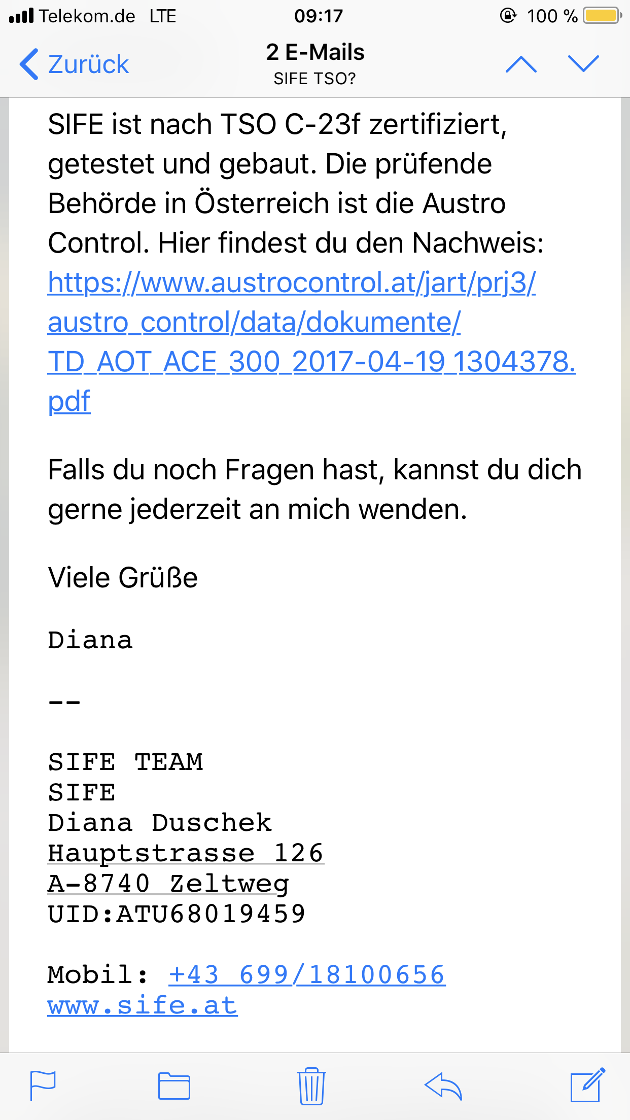

Pobrause 6 #27 January 9, 2018 As Austro Control is regulated by/ a national Department of EASA it IS tso‘d under EASA and therefore tso‘d under TSO c-23 f in any sense of the word and SIFE confirmed this to me. At least that‘s my understanding of a conversation with the manufacturer. Attached one of their replies in german, can‘t find the mail where Diana mentioned the EASA part atm. ------------------------------------------------------- To absent friends Quote Share this post Link to post Share on other sites
shadeland 5 #28 January 9, 2018 Pobrause As Austro Control is regulated by/ a national Department of EASA it IS tso‘d under EASA and therefore tso‘d under TSO c-23 f in any sense of the word and SIFE confirmed this to me. At least that‘s my understanding of a conversation with the manufacturer. Attached one of their replies in german, can‘t find the mail where Diana mentioned the EASA part atm. TSO is a US FAA standard, though other countries adopt its methodologies. It doesn’t look like Sife has a TSO approval from the US FAA (or at least it’s realllly not clear), which would mean you can’t jump it in the us unless you’re a non-US visitor. Quote Share this post Link to post Share on other sites
Deyan 36 #29 January 9, 2018 Pobrause As Austro Control is regulated by/ a national Department of EASA it IS tso‘d under EASA and therefore tso‘d under TSO c-23 f in any sense of the word and SIFE confirmed this to me. At least that‘s my understanding of a conversation with the manufacturer. Attached one of their replies in german, can‘t find the mail where Diana mentioned the EASA part atm. EASA doesn't regulate the manufacturing of sport parachutes since 2006. I don't care what the manufacturer claims. They do not have an FAA or EASA TSO. Based on the EU law, if it's approved in one of the EU countries, the rest should allowed it too. That's the loophole they are using. Funny times ahead with the Brexit. It can happen that since TS only have the UK approval, some EU countries might ban their products once UK leave the union.... ETA: EASA outsourced the control of certifying skydiving gear for sport use to the local authorities for each country . Only the PEPs are left under EASA's scope! So if Austro Control certified SIFE, that doesn't mean they hold an EASA TSO c23f. ETA 2: To the OP, sorry for changing the subject. My advice has always been, talk to your rigger. He/she is the person that will have to deal with that gear/manufacturer. And don't forget the resale value, because the reality is, you will be selling that rig at some point."My belief is that once the doctor whacks you on the butt, all guarantees are off" Jerry Baumchen Quote Share this post Link to post Share on other sites
shadeland 5 #30 January 9, 2018 Deyan ***As Austro Control is regulated by/ a national Department of EASA it IS tso‘d under EASA and therefore tso‘d under TSO c-23 f in any sense of the word and SIFE confirmed this to me. At least that‘s my understanding of a conversation with the manufacturer. Attached one of their replies in german, can‘t find the mail where Diana mentioned the EASA part atm. EASA doesn't regulate the manufacturing of sport parachutes since 2006. I don't care what the manufacturer claims. They do not have an FAA or EASA TSO. Based on the EU law, if it's approved in one of the EU countries, the rest should allowed it too. That's the loophole they are using. Funny times ahead with the Brexit. It can happen that since TS only have the UK approval, some EU countries might ban their products once UK leave the union.... Does Thomas Sport have an FAA TSO? Quote Share this post Link to post Share on other sites
skytribe 17 #31 January 9, 2018 shadeland ******As Austro Control is regulated by/ a national Department of EASA it IS tso‘d under EASA and therefore tso‘d under TSO c-23 f in any sense of the word and SIFE confirmed this to me. At least that‘s my understanding of a conversation with the manufacturer. Attached one of their replies in german, can‘t find the mail where Diana mentioned the EASA part atm. EASA doesn't regulate the manufacturing of sport parachutes since 2006. I don't care what the manufacturer claims. They do not have an FAA or EASA TSO. Based on the EU law, if it's approved in one of the EU countries, the rest should allowed it too. That's the loophole they are using. Funny times ahead with the Brexit. It can happen that since TS only have the UK approval, some EU countries might ban their products once UK leave the union.... Does Thomas Sport have an FAA TSO? Just from a dim distant memory - Didn't Thomas Sports have a TSO through bilateral airworthiness agreements with Australia or something like that. Quote Share this post Link to post Share on other sites
Deyan 36 #32 January 9, 2018 skytribe Just from a dim distant memory - Didn't Thomas Sports have a TSO through bilateral airworthiness agreements with Australia or something like that. There was something indeed. However on the latest rig from them, on the label was written only the UK certificate. The abbreviation FAA wasn't written anywhere!"My belief is that once the doctor whacks you on the butt, all guarantees are off" Jerry Baumchen Quote Share this post Link to post Share on other sites

shadeland 5 #36 January 10, 2018 Pobrause As Austro Control is regulated by/ a national Department of EASA it IS tso‘d under EASA and therefore tso‘d under TSO c-23 f in any sense of the word and SIFE confirmed this to me. At least that‘s my understanding of a conversation with the manufacturer. Attached one of their replies in german, can‘t find the mail where Diana mentioned the EASA part atm. I confirmed with Sife, they do not have a USA TSO certification. It cannot be jumped legally in the US by US citizens, though foreign visitors may be able to jump it (though I think the reserve needs to be packed/sealed by a FAA certified rigger) Quote Share this post Link to post Share on other sites
