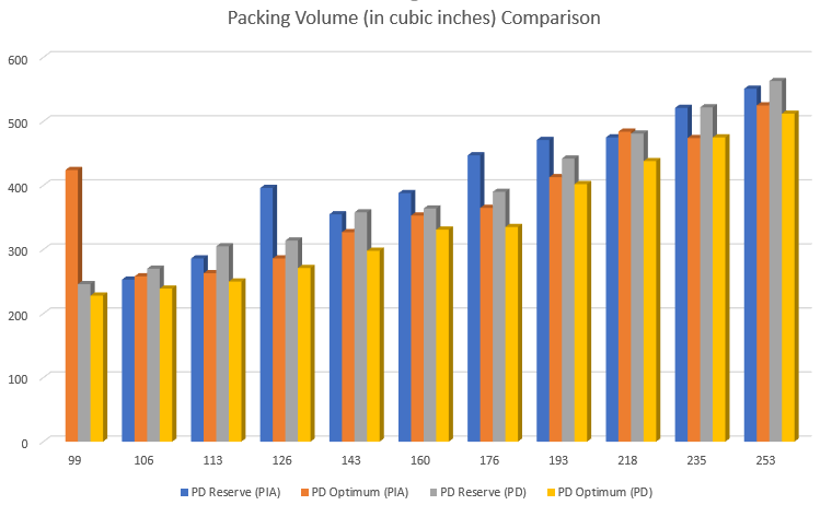

shadeland 5 #11 February 6, 2018 I made a graph, but I'm not sure it would help. I used a PIA document (link below) as well as the PD Reserve manuals reported volume, and came up with some interesting numbers. PIA Document: http://www.rigginginnovations.com/files/Docuemnts/Other/PIA%20Canopy%20Volume.pdf PD Reserve Manual: http://www.performancedesigns.com/docs/Reserve_manual.pdf The variances with the PIA chart are pretty wide, and its covered in this document here (at the bottom): http://www.performancedesigns.com/docs/packvol.pdf Quote Share this post Link to post Share on other sites
Deimian 43 #12 February 6, 2018 Clicky PIA Document: http://www.rigginginnovations.com/files/Docuemnts/Other/PIA%20Canopy%20Volume.pdf PD Reserve Manual: http://www.performancedesigns.com/docs/Reserve_manual.pdf Variances: http://www.performancedesigns.com/docs/packvol.pdf The PIA volume for Optimum 99 is nonsense. It can't pack bigger than an Optimum 193. Which makes you question the accuracy of the other stated volumes.... Quote Share this post Link to post Share on other sites
shadeland 5 #13 February 6, 2018 Yeah that one was pretty crazy. The PIA was generally all over the map. Quote Share this post Link to post Share on other sites
