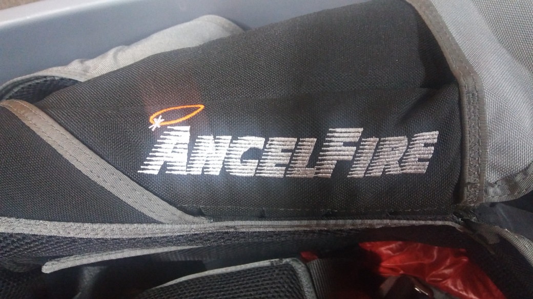

Unstable 9 #12 April 6, 2018 My big canopy rig came with an AF logo on it (but I have a Raven 218 in this one, but nobody knows that....) =========Shaun ========== Quote Share this post Link to post Share on other sites
