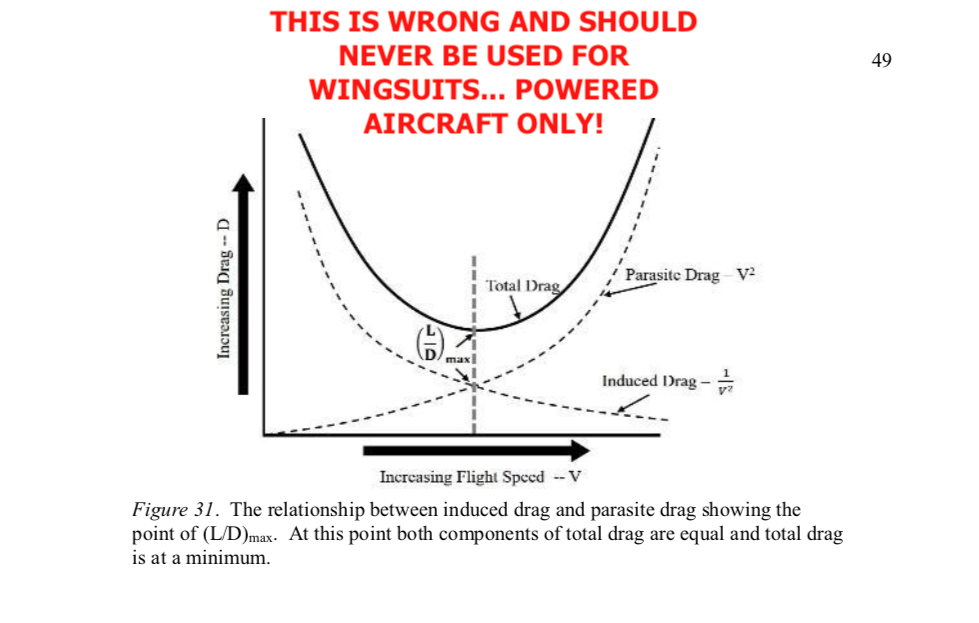

aonsquared 9 #11 September 6, 2018 QuoteUnfortunately, the way they teach aerodynamics to aeronautical students, pounds this fallacy into their brain. From my observations over the years, aeronautical students and engineers do not have a solid grasp of fundamental physics concepts to recognize this fallacy. They fall into this pothole every. single. time. I'm an aerospace engineer, and I don't know anyone who actually takes that plot as no more than a rough approximation of drag. The drag increase towards zero does not actually go to infinity, as it levels off at stall speed. You say that drag is proportional to just the square of airspeed ( D~=v^2) but you've probably measured that drag with a constant angle of attack. The reason why the induced drag in the graph increases with decreasing speed is that you need to increase the angle of attack to maintain straight and level flight as you get slower. So yes, this graph is usually meant for powered aircraft in straight and level flight rather than gliding flight. However, in gliding flight you still need to take this graph seriously. Why? Because your lift must still equal your weight! If you are flying your best glide angle, and your lift is not equal to your weight, then your speed will not be constant. You will be accelerating. As you yourself said, F = ma. So, if lift is not equal to your weight, L - W = ma, which will accelerate you towards the ground. So if your definition of a good wingsuit flight is a parabolic trajectory towards the ground, I'm not sure how many people would agree with you. On the other hand, I do agree with you that CFD in wingsuit situations needs to be taken with a large grain of salt. Low Reynolds numbers, large amounts of turbulence and large aeroelastic effects are not easy to simulate accurately even with the latest CFD algorithms. Quote Share this post Link to post Share on other sites
yuri_base 1 #12 September 6, 2018 aonsquaredYou say that drag is proportional to just the square of airspeed ( D~=v^2) but you've probably measured that drag with a constant angle of attack. The reason why the induced drag in the graph increases with decreasing speed is that you need to increase the angle of attack to maintain straight and level flight as you get slower. So yes, this graph is usually meant for powered aircraft in straight and level flight rather than gliding flight. Exactly. The aircraft has to change its AoA to maintain level flight if it wants to fly slower or faster, so that graph and formulas for induced and parasitic drag reflect that. A simple numeric illustration. We have a 1000kg plane flying level at 200km/h, with AoA=4 degrees and L/D = 10. We have a simple "cross" force diagram: weight W = 1000kg is down, lift L = 1000kg is up, drag D = L/(L/D) = 100kg back, and thrust T = D = 100kg forward. Now the plane wants to fly level at 141km/h (200 deviced by sqrt(2)). If it doesn't change AoA, the lift (and drag, too!) will decrease by a factor of 2, since aerodynamic force is proportional to V^2. Now the lift is only 500kg - half the weight, the plane can't fly level! (the drag will be 50kg) We need to increase the lift by 2x. So we increase AoA to 8 degrees, since for thin wings the lift is proportional to AoA in a range of about 0-10 degrees. Now lift is 2x (1000kg), but drag is roughly proportional to the square of AoA (there's an offset to parabola - non-zero drag at zero AoA, but let's ignore it for the purpose of illustration), so the drag now is 50*4 = 200kg! So the airspeed decreased by sqrt(2), but the drag increased by 2x. This illustrates why for powered aircraft flying level at constant speed, drag increases as the plane tries to fly slower. This is because they have to increase AoA to maintain level flight, which leads to sharply increasing drag. This is not applicable to non-powered aircraft. aonsquaredHowever, in gliding flight you still need to take this graph seriously. Why? Because your lift must still equal your weight! If you are flying your best glide angle, and your lift is not equal to your weight, then your speed will not be constant. You will be accelerating. As you yourself said, F = ma. No, even for sustained flight, lift is not equal weight, this is because the force diagram is different, there are only 3 forces, and L and D are angled to W (all this is explained in The Great Confusion post). For sustained non-powered flight, L = W*(L/D)/sqrt(1 + (L/D)^2) D = W/sqrt(1 + (L/D)^2) For non-constant speed, Wingsuit Equations are needed. The calculated lift and drag vs. time can be seen in the graphs of my jumps above. How these calculations are done, is explained in the article How L/D Magic Works: once the "magic" coefficients of lift and drag Kl and Kd are found, lift and drag can be calculated as: L = W·Kl·V^2 D = W·Kd·V^2Android+Wear/iOS/Windows apps: L/D Vario, Smart Altimeter, Rockdrop Pro, Wingsuit FAP iOS only: L/D Magic Windows only: WS Studio Quote Share this post Link to post Share on other sites
aonsquared 9 #13 September 6, 2018 QuoteNo, even for sustained flight, lift is not equal weight, this is because the force diagram is different All the forces need to balance to zero if it's moving at a constant speed (either straight and level, or a straight-line unpowered glide). The only difference between powered and unpowered is that unpowered, you're using a bit of your weight vector (W*sin(theta)) to push against whatever drag you're experiencing. Your wing won't generate a force perpendicular to the earth, but the component of that force vector perpendicular to the ground (L*cos(theta)) needs to be equal to your weight, otherwise you will be accelerating rather than staying at a constant descent velocity. I don't think you've explained very well WHY the standard drag polar is not applicable to unpowered flight. Unpowered flight has been around for way, way longer than wingsuits have. Unpowered gliding flight has even been around for longer than powered flight. I hate to break this to you but, your equations are wrong. Quote Share this post Link to post Share on other sites
yuri_base 1 #14 September 6, 2018 aonsquaredI don't think you've explained very well WHY the standard drag polar is not applicable to unpowered flight. Because wingsuits (and any nonpowered AC) do not have the goal (and means) to maintain the level flight. So we do not change AoA to maintain LF at different speeds; we change our AoA to do, for example, a flare, or to do a fast start in BASE, or adjust it to find some sweet spot, whether it's distance, time, or speed; or to stay in formation; etc. etc. We cannot fly level at constant speed like planes do! aonsquaredI hate to break this to you but, your equations are wrong. No, they are correct. Prove mathematically that they are wrong!Android+Wear/iOS/Windows apps: L/D Vario, Smart Altimeter, Rockdrop Pro, Wingsuit FAP iOS only: L/D Magic Windows only: WS Studio Quote Share this post Link to post Share on other sites
aonsquared 9 #15 September 6, 2018 QuoteBecause wingsuits (and any nonpowered AC) do not have the goal (and means) to maintain the level flight I never said it was. I said the goal was constant velocity, not constant altitude. So if your force diagram does not balance to zero then your equations are already wrong. Because F = ma. Again, I'm sorry for saying it like this. You seem fairly good at maths, but it's really quite unlikely that you've found a groundbreaking new equation. Wingsuiters, as well as any other form of gliding flight, are probably better off using standard aerodynamics equations. Blue skies! Quote Share this post Link to post Share on other sites
yuri_base 1 #16 September 6, 2018 aonsquaredSo if your force diagram does not balance to zero then your equations are already wrong. Because F = ma. Which equations? I wrote several above, QuoteFor sustained non-powered flight, L = W*(L/D)/sqrt(1 + (L/D)^2) D = W/sqrt(1 + (L/D)^2) For both sustained or non-sustained, non-powered: QuoteL = W·Kl·V^2 D = W·Kd·V^2 And then Wingsuit Equations - they are simply F=ma in expanded form for non-powered flight, for any velocity, sustained or changing. So, which equations are wrong in their respective conditions and where is the math to show it? aonsquaredAgain, I'm sorry for saying it like this. You seem fairly good at maths, but it's really quite unlikely that you've found a groundbreaking new equation. Yes, I did find groundbreaking equations - Wingsuit Equations, in 2006. I also invented the ways of measuring L/D and other aerodynamic parameters by using accelerometer and other sensors on a vane in undisturbed airflow. aonsquaredWingsuiters, as well as any other form of gliding flight, are probably better off using standard aerodynamics equations. In my opinion, it's quite possible that this is what killed Geo Robson. He used "standard aerodynamics equations" and grossly overestimated his flight path. He didn't "get" WSE (the only person in Solar System other than me who gets them, is Hartman Rector). It almost seems that aerospace engineers hit a wall when one talks physics and math. They often lack even basics. A very clear example of this is #8, a 1000-page dissertation for "Ph.D. in Aviation" (!) - not only it has this wrong drag plot and [unnecessary for wingsuits] separation of drag into induced and parasitic, but the whole method of studying effects of fabric roughness on wingsuits is grossly wrong, because taking a high-L/D section of a wing and covering it in fabric and seeing L/D dramatically decrease by half, has little relevance to wingsuits as our L/D is much much lower to begin with, so the effect of rough fabric will be probably within 5%.Android+Wear/iOS/Windows apps: L/D Vario, Smart Altimeter, Rockdrop Pro, Wingsuit FAP iOS only: L/D Magic Windows only: WS Studio Quote Share this post Link to post Share on other sites
aonsquared 9 #17 September 6, 2018 QuoteL = W*(L/D)/sqrt(1 + (L/D)^2) D = W/sqrt(1 + (L/D)^2) Those are not equations. That's like saying 1=2. QuoteI also invented the ways of measuring L/D and other aerodynamic parameters by using accelerometer and other sensors on a vane in undisturbed airflow. I'd strongly suggest you publish your wingsuit equations in a reputable academic journal then, it would be good to see full methodology and get it through peer review. I'd also recommend using Microsoft Equation or LaTeX when you typeset your equations to make the equations easier to read in your PDF. Quote Share this post Link to post Share on other sites
yuri_base 1 #18 September 6, 2018 aonsquaredQuoteL = W*(L/D)/sqrt(1 + (L/D)^2) D = W/sqrt(1 + (L/D)^2) Those are not equations. That's like saying 1=2. These are equations. They allow one to calculate lift and drag, given L/D and weight, for sustained flight. Yes, they are simple Pythagorean cathetuses from right triangle force diagram (W is hypothenuse, L and D are sides). That doesn't make them "not equations". aonsquaredI'd strongly suggest you publish your wingsuit equations in a reputable academic journal then, it would be good to see full methodology and get it through peer review. I feel no need. I'm not affiliated with any academic institution, so don't think this is even possible for a person "from the street" to publish articles in academic journals. For me, it's sufficient to do the way I do it. For those writing academic articles and even Ph.D. dissertations, it's an academic shame not to mention (either intentionally, or genuinely not knowing it and not simply googling around a little) the prior art that has been developed 12 years ago. Other than Hartman #5, none from the list #1-#8 mention it. It's pure ridiculousness.Android+Wear/iOS/Windows apps: L/D Vario, Smart Altimeter, Rockdrop Pro, Wingsuit FAP iOS only: L/D Magic Windows only: WS Studio Quote Share this post Link to post Share on other sites
aonsquared 9 #19 September 6, 2018 You can't have L isolated on one side of the equation then have it on the other side too. Same with D. Equations need to be equal (that's why they're called equations). QuoteI feel no need. Well, the burden of proof is really to prove that your "equations" are correct, as you haven't provided any proof that the prevailing academic thought on aerodynamics is wrong. And please stop using a dead person as proof. Anecdotes are not data. The burden of proof should be on you as you're using them to instruct other wingsuiters and if they change their behaviour according to your possibly incorrect formulas, you should have the experimental data to back it up. I don't have time to fully review your experimental methods, but without wind tunnel tests and only relying on wingsuit jumps with variable weather data (you did record all wind conditions, temperatures, pressures, and humidity, right?), with noisy instruments that have not been calibrated against laboratory references, and of course a very variable and very human test model, lack of convergence testing and instrument parameters, lack of error bars in your final graphs - there's a lot to work on. Quote Share this post Link to post Share on other sites
yuri_base 1 #20 September 6, 2018 aonsquaredYou can't have L isolated on one side of the equation then have it on the other side too. Same with D. Equations need to be equal (that's why they're called equations). (L/D) on the right side is used as a notation for a number, not as literal lift devided by drag. I can denote it by some letter, e.g. greek gamma. In the absence of rich formatting here, I get around this limitation by enclosing the number L/D in parenthesis: (L/D). For example, if L/D=2.5, just substitute 2.5 wherever there's (L/D). Same for drag in sustained level flight: D = L/(L/D). It's not literal (otherwise, it's like D=D). It's "take the lift (1000kg), devide by L/D of the plane (10), you get drag 1000/10=100kg". I thought this was pretty obvious. aonsquaredWell, the burden of proof is really to prove that your "equations" are correct, as you haven't provided any proof that the prevailing academic thought on aerodynamics is wrong. I proved that they are correct by deriving them using proven physics (I'm Ph.D. in Physics) and aerodynamics laws. The derivation is here: http://www.pureflyingmagic.com/Content/Knowledge/Resources/Articles/en/WingsuitEquations.pdf I have no further "burden". If anyone scientifically proves them wrong, not just saying they are wrong, then I will have a burden to confirm my mistake. This hasn't happened yet. (And I strongly think, it never will.) aonsquaredThe burden of proof should be on you as you're using them to instruct other wingsuiters and if they change their behaviour according to your possibly incorrect formulas, you should have the experimental data to back it up. I've done it many times, both deriving my aerodynamic parameters from my flights, and using this data to model flight. Hartman does this even in 3D! aonsquaredI don't have time to fully review your experimental methods, but without wind tunnel tests and only relying on wingsuit jumps with variable weather data (you did record all wind conditions, temperatures, pressures, and humidity, right?), with noisy instruments that have not been calibrated against laboratory references, and of course a very variable and very human test model, lack of convergence testing and instrument parameters, lack of error bars in your final graphs - there's a lot to work on. Yes, there's a lot to work on, but a lot of work is done already. I collected some of my work in OP, the burden to study it is not on me. Actually, using jumps as a personal research windtunnel is way more superior to lab windtunnels, because 1) it's you, and in your suit tailored for you, not some other guy in a different suit or build; 2) laying on a measurement platform, waiting to get strapped, the blower motors to reach their speed, etc. is tiring, so the test pilot in windtunnel may have a body position not reproducing the real one in flight; when jumping, one has their real body position and can measure true aerodynamic parameters of it; 3) platform itself can introduce errors in measured lift and drag since it is big and interferes with the flow and can't be just subtracted (unlike thin mounting hardware for wing sections). Re: wind conditions. L/D Magic and L/D Vario on a vane completely exclude wind, since the vane points into relative wind. They measure the motion relative to air, no ground (like GPS). Altitude pressure is taken into account, of course. Effects of humidity and temperature are relatively minor and are ignored for now (but now that Nixon Mission smartwatch has a humidity and temperature sensors, it can be done). "a very variable and very human test model" - yes, and it's yourself, which is the best. I'm not fit and very heavy, so, for example, Hartman's data will have little relevance to me. What I need for me is my data. Instrument noise is taken into account by L/D Magic's Kalman filters. Calibration is a big issue, need to, for example, put the pole with L/D Magic/Vario on a car in clean airflow and drive on a level road to calibrate 0.0. There's a lot of work to do, unfortunately, other than me jumping with vanes and Hartman using GPS data, no one has done any meaningful work in deducing the real aerodynamic parameters of wingsuits and applying them to modeling. In 12 years. In the whole Solar System. That's the state of the wingsuit industry today. 20-year long coma. And continuing indefinitely, it seems.Android+Wear/iOS/Windows apps: L/D Vario, Smart Altimeter, Rockdrop Pro, Wingsuit FAP iOS only: L/D Magic Windows only: WS Studio Quote Share this post Link to post Share on other sites
aonsquared 9 #21 September 6, 2018 We use subscripts, e.g. C_L and C_d to denote lift and drag coefficients. If you're a PhD then you should know how the peer review process works! (And if you're a PhD then you would also have published a few academic papers - so you're not really 'outside' the system are you?) Quote(And I strongly think, it never will.) um... QuoteInstrument noise is taken into account by L/D Magic's Kalman filters. That's not how noise works...did you do any experiments during your Physics PhD? QuoteIn the whole Solar System. Right... I'm done here. Good luck! Quote Share this post Link to post Share on other sites

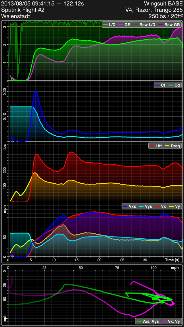

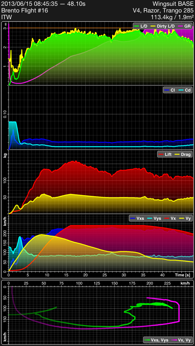

aonsquared 9 #24 September 6, 2018 QuoteThe solution of these is: Kl = Vxs/Vs^3 Kd = Vys/Vs^3 With these adjusted coefficients, the wingsuit equations are dVx/dt = g*V*(Kl*Vy - Kd*Vx) dVy/dt = g*(1 - V*(Kl*Vx + Kd*Vy)) Now the unknown wingsuit parameters (wingloading mg/S and aerodynamic properties Cl, Cd) are "hidden" inside coefficients Kl and Kd, which can be easily calculated from sustained horizontal and vertical speeds. Sigh. You treated C_l and C_d as constants. Which means if you use the equations that you used in the beginning: D = 1/2 rho * V^2* S *C_d Then yes, setting V to 0 will result in D = 0. Is this why you think the drag polar is invalid? Because of D = qSC_d? Also, you said in the post: QuoteWe have 2 equations for 3 unknowns (k and Cl, Cd). But note that if we combine k with the Cl and Cd into "adjusted" lift and drag coefficients (no longer nondimensional) Which is incorrect. k is known - it's 0.5*rho*S/m which is constant (rho = approximately 1.225 kg/m^3). So I'm not sure why you had to condense them to yet another set of coefficients. It's understandable why D = 0 if V = 0 when you use that equation, but this drag term is not a constant - it's a condensed set of coefficients itself and is itself calculated with another equation. The drag polar was not derived from the equation you started with, which is why you got a different result. The equation you started with has been extremely simplified. The V in this equation also denotes airspeed, and GPS measurements only measure ground speed. Please refrain from personal attacks. Quote Share this post Link to post Share on other sites
yuri_base 1 #25 September 6, 2018 aonsquaredQuoteThe solution of these is: Kl = Vxs/Vs^3 Kd = Vys/Vs^3 With these adjusted coefficients, the wingsuit equations are dVx/dt = g*V*(Kl*Vy - Kd*Vx) dVy/dt = g*(1 - V*(Kl*Vx + Kd*Vy)) Now the unknown wingsuit parameters (wingloading mg/S and aerodynamic properties Cl, Cd) are "hidden" inside coefficients Kl and Kd, which can be easily calculated from sustained horizontal and vertical speeds. Sigh. You treated C_l and C_d as constants. Which means if you use the equations that you used in the beginning: D = 1/2 rho * V^2* S *C_d Then yes, setting V to 0 will result in D = 0. Is this why you think the drag polar is invalid? Because of D = qSC_d? The equation for D is "the whole pie", as I explained in my reply to Geo. Splitting the drag "pie" into two parts, while can be done, is totally unnecessary for wingsuits. We still have to eat the whole pie. Split is useful for powered aircraft flying level at constant speed. Does not apply to us. aonsquaredAlso, you said in the post: QuoteWe have 2 equations for 3 unknowns (k and Cl, Cd). But note that if we combine k with the Cl and Cd into "adjusted" lift and drag coefficients (no longer nondimensional) Which is incorrect. k is known - it's 0.5*rho*S/m which is constant (rho = approximately 1.225 kg/m^3). So I'm not sure why you had to condense them to yet another set of coefficients. Because, QuoteWith these adjusted coefficients, the wingsuit equations are dVx/dt = g*V*(Kl*Vy - Kd*Vx) dVy/dt = g*(1 - V*(Kl*Vx + Kd*Vy)) Now the unknown wingsuit parameters (wingloading mg/S and aerodynamic properties Cl, Cd) are "hidden" inside coefficients Kl and Kd, which can be easily calculated from sustained horizontal and vertical speeds. aonsquaredIt's understandable why D = 0 if V = 0 when you use that equation, but this drag term is not a constant - it's a condensed set of coefficients itself and is itself calculated with another equation. The drag polar was not derived from the equation you started with, which is why you got a different result. The equation you started with has been extremely simplified. Yes, Kl and Kd vary with angle of attack, and they form a polar curve in [Kl, Kd] space. This curve can be obtained from "natural research windtunnel" - your own flights. And can be subsequently used in modeling, for example, answering questions: what sequence of flight modes (Kl, Kd pairs) would be a winning strategy for competition in speed? in distance? in time? etc. I strongly recommend contacting Hartman, may be he will share his brilliant spreadsheet that uses 3D WSE. (maybe he already posted it somewhere on social media, idk) aonsquaredThe V in this equation also denotes airspeed, and GPS measurements only measure ground speed. Yes, I only operate with airspeed. GPS measurements cannot be trusted since the wind is never known with sufficient for us accuracy. L/D Vario and L/D Magic with the first two Kalman Filter models (with accelerometer and accelerometer+gyro when iphone is mounted on a vane) are completely independent from wind influence since the vane always point into relative wind, not apparent ground impact point.Android+Wear/iOS/Windows apps: L/D Vario, Smart Altimeter, Rockdrop Pro, Wingsuit FAP iOS only: L/D Magic Windows only: WS Studio Quote Share this post Link to post Share on other sites
