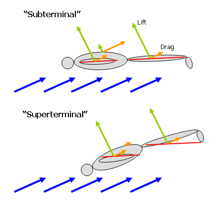

Yes, but how? I think this is where the idea of placing the body at zero AoA and having non-zero AoI for the wings could probably shine (it's unproven so far, though). I did some estimates, and it seemed to be feasible.
[inline ZeroBodyAoA.jpg]
This picture is not exactly what I have in mind: upper legs should be bent a bit at the hips, but lower legs should be parallel to torso, so both torso and lower legs are at zero AoA, wings are at non-zero AoA (equal to AoI in this case).
The airflow above torso will be then much smoother, since it's essentially in "headdown", or "speed skydiving" position to relative wind, and the drag should be greatly reduced. And is argued in the calculations above, the loss of drag will be advantageous despite loss of lift from the body, since body has such poor L/D by itself (0.7-1.0).

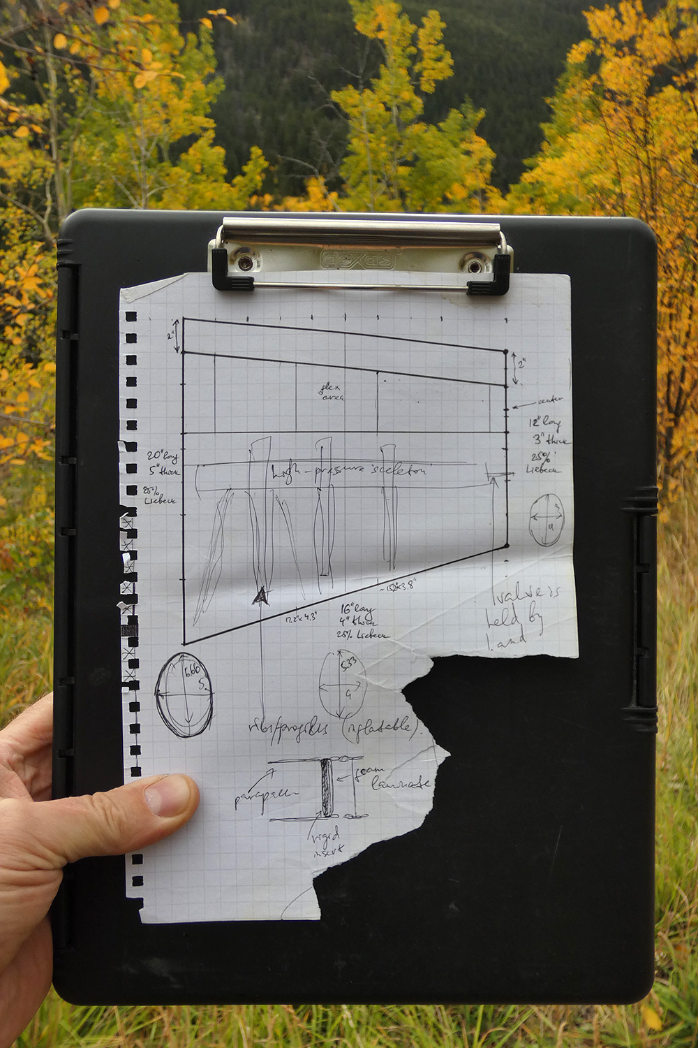

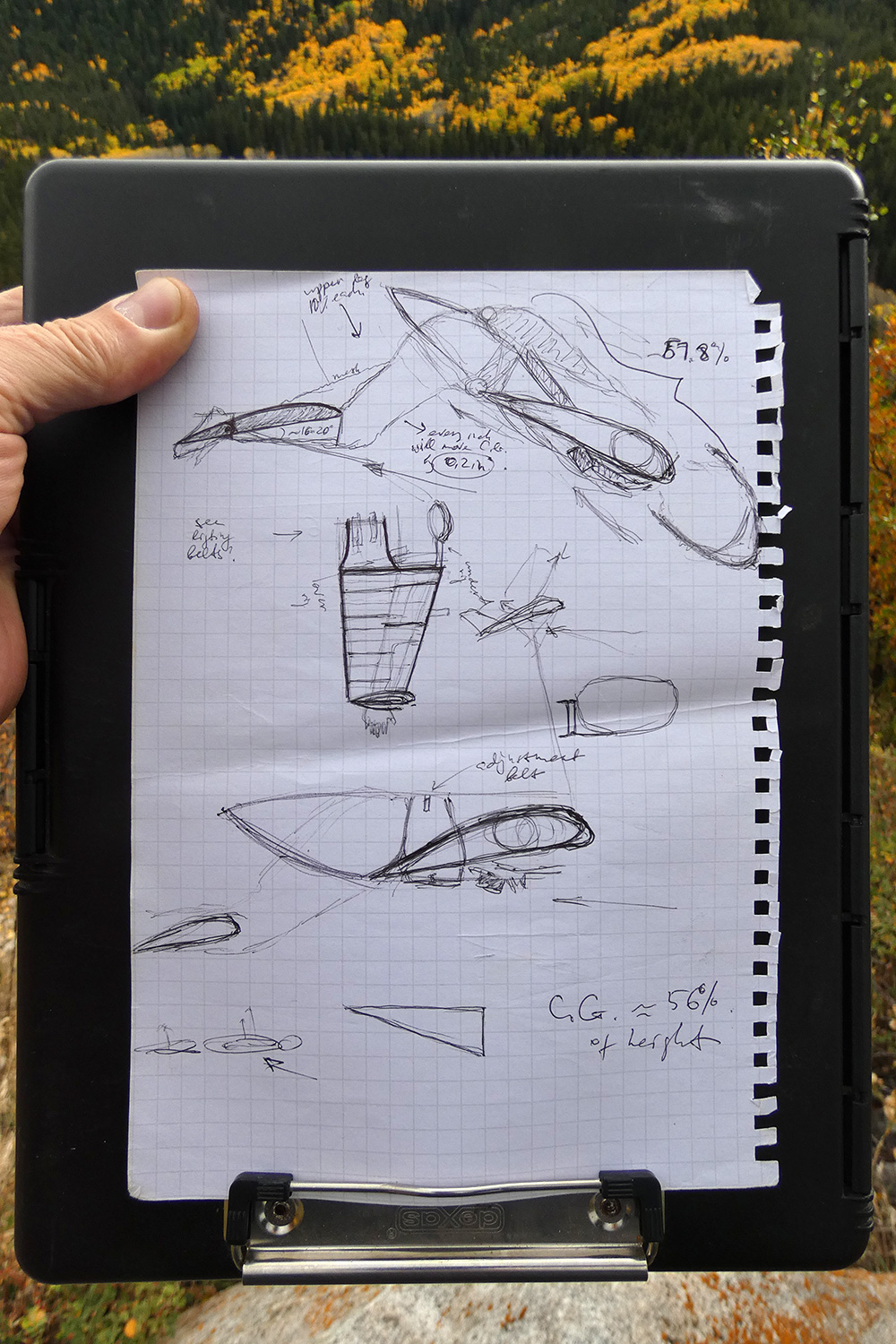

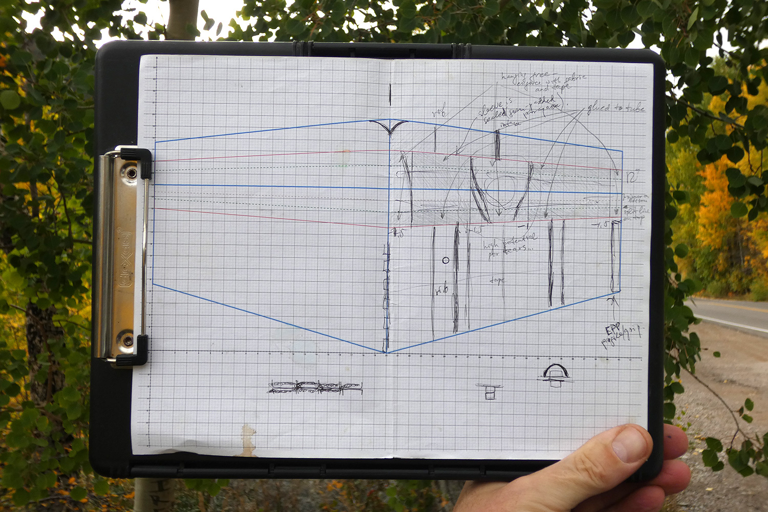

Found some old sketches back from 2008. These are very rudimentary and messy, but I hope they are sufficient to give one the general idea. I hope someone will like the idea and start working on this, as I simply cannot do everything myself, I have so much work to do in WS theory and software, I better focus on those.
The goal is to build the highest L/D wingsuit (wing system) in the world, in human history. The goal is to make it DIY, so anyone with even basic DIY skills can build one for themselves. The goal is to make it affordable, with bill of materials in $100-200 range. The goal is to make it modular, so that different arm and leg wings (different airfoil profile, planform, thickness, etc.) can be installed on the same belly and leg platforms. The goal is to make it adjustable, so that basic parameters like AoI, trim/balance can be adjusted between the jumps. The goal is to stop sewing costumes, and start engineering flying machines. The goal is to make it open source, so that anyone in the world (every WSB 'employee') can make a contribution, or branch off, or even go commercial and make money, if they want. The goal is freedom from the state of CoW, from The Stooges, from 20 years of The Great Stagnation.
"Every once in a while, a revolutionary product comes along that changes everything. Well, today, we’re introducing three revolutionary products.
The first one: is a DIY, open source wingsuit.
The second: is a revolutionary modular wing system.
And the third is a breakthrough experimental platform.
So, three things: a DIY, open source wingsuit; a revolutionary modular wing system; and a breakthrough experimental platform.
A DIY wingsuit, a modular wing system, and an experimental platform. A DIY wingsuit, a modular wing system … are you getting it?
These are not three separate devices, this is one device, and we are calling it THE MACHINE.
Today Wing Systems Blockchain is going to reinvent the wingsuit, and here it is." :D
- this is just for a laugh, a flashback to Steve Jobs' introduction of iphone, but who knows, maybe this, not mattresses, will become the platform of the future?... Let's do it! Everybody, welcome to THE MACHINE!!!
Welcome my son, welcome to THE MACHINE
Where have you been?
It's alright we know where you've been
You've been in the pipeline, filling in time
Provided with toys and 'scouting for boys'
You brought a guitar to punish your ma
And you didn't like school, and you
Know you're nobody's fool
So welcome to THE MACHINE

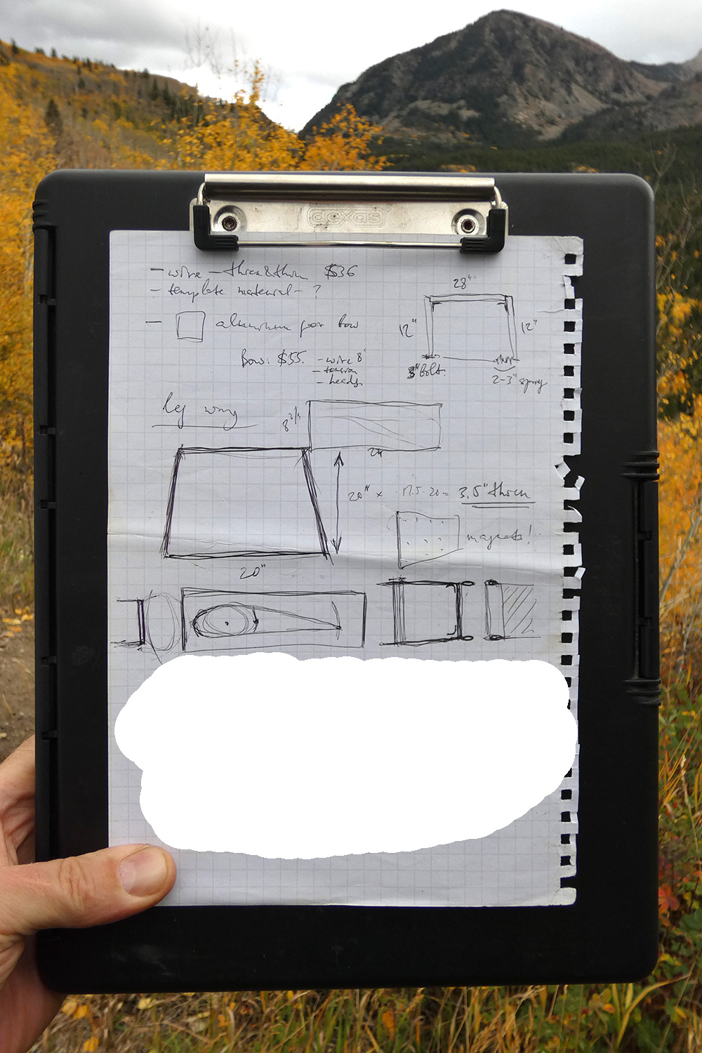

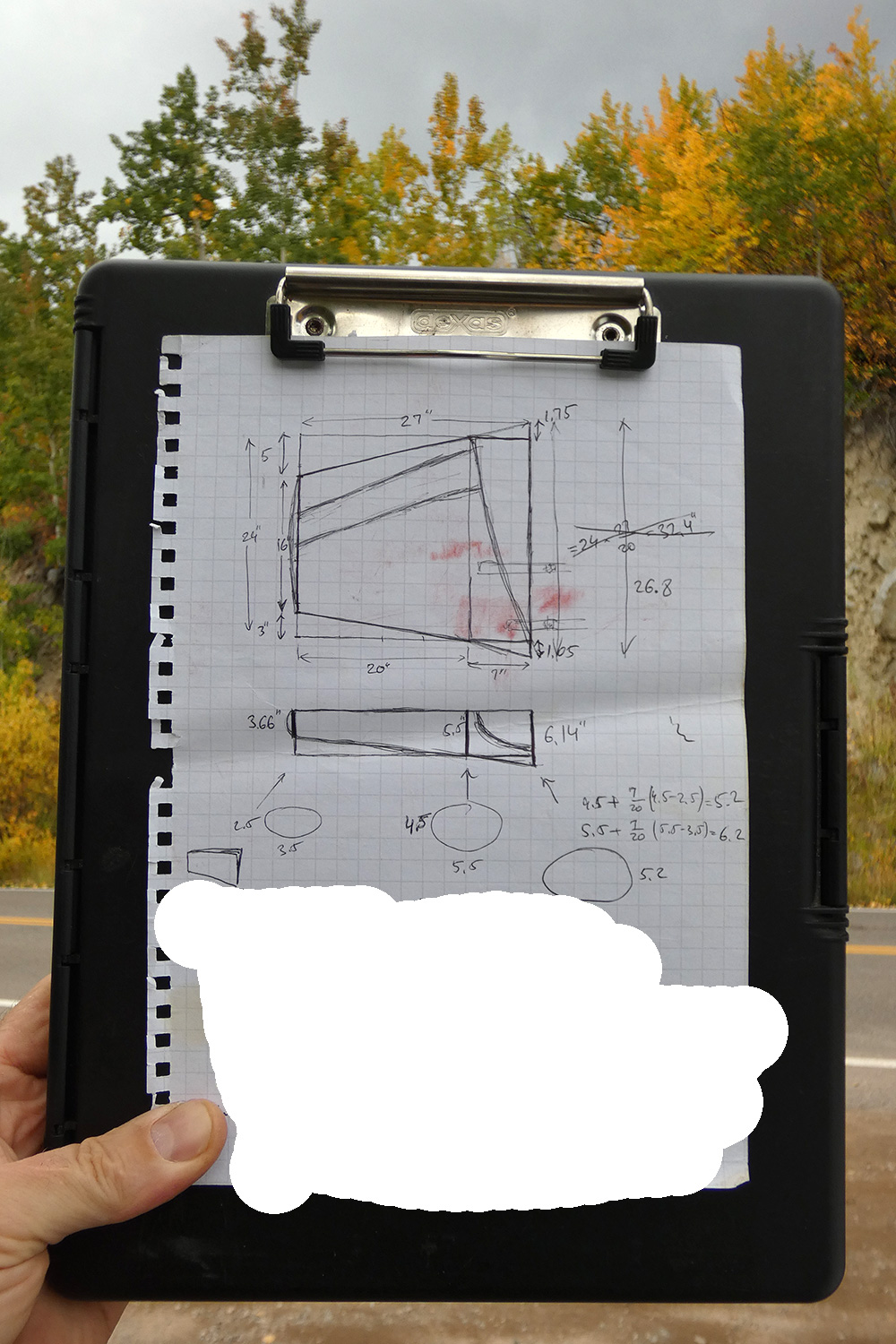

1. Body at zero AoA, arm wings at non-zero AoI; same with leg wing, which starts from knees down, with distinct leading edge; upper legs bent at hips, but not as much as in the pic, maybe about 30 degrees.
[inline TheMachineSketch2008-1.jpg]
2. Some dimension and planform prototyping.
[inline TheMachineSketch2008-2.jpg]

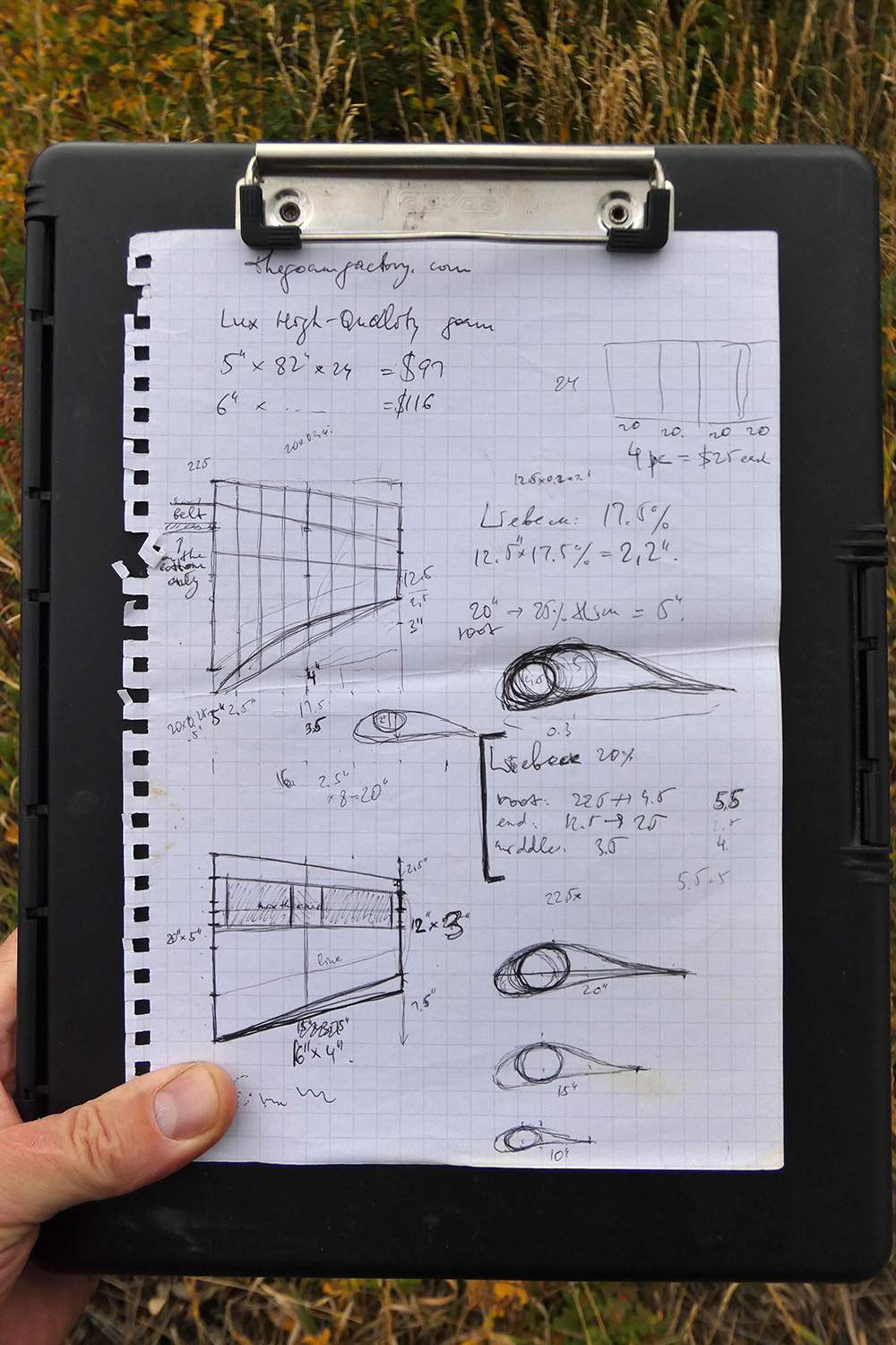

3. Foam (PU foam, high-resilience, "blue foam", "lux high quality foam") needs to be about 5" for the arms. Liebeck high-lift airfoil is used, with 25% thickness. Foam is not cheap for individual purchase, but for 80 or so bucks you get approx. twin-sized "mattress", enough for complete wing system.
[inline TheMachineSketch2008-3.jpg]
4. Leg wing has trapezoid shape, these dimensions make a small wing, but it can be made bigger.
[inline TheMachineSketch2008-4.jpg]
5. Arm wing sample dimensions.
[inline TheMachineSketch2008-5.jpg]
6. Arm wing dimensions and the elliptical cut out to for the arm.
[inline TheMachineSketch2008-6.jpg]

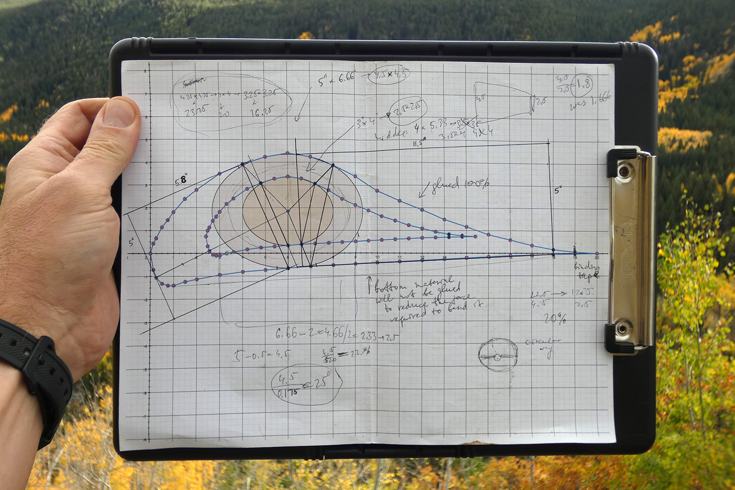

7. Liebeck airfoil profile at the root of the arm wing and at the tip.
[inline TheMachineSketch2008-7.jpg]
8. Arm wing channel, leading edge and trailing edge with possible stiffeners.
[inline TheMachineSketch2008-8.jpg]
All this is, of course, very raw, just sketches, is as far from a finished product as it could be. But I hope someone will find this useful and start working on building something like this.
The most difficult parts, I think, are wing attachment platforms (that are attached to belly and lower legs with adjustable belts, and then wings attach to those with some kind of quick connection, with adjustable AoI) and arm wing's arm channel and ability to free arms using a zipper, yet not affecting the precise airfoil shape of it. "Hiring" genius mechanical engineers! :) "Hiring" anyone smart! Everyone is welcome... welcome to The Machine!

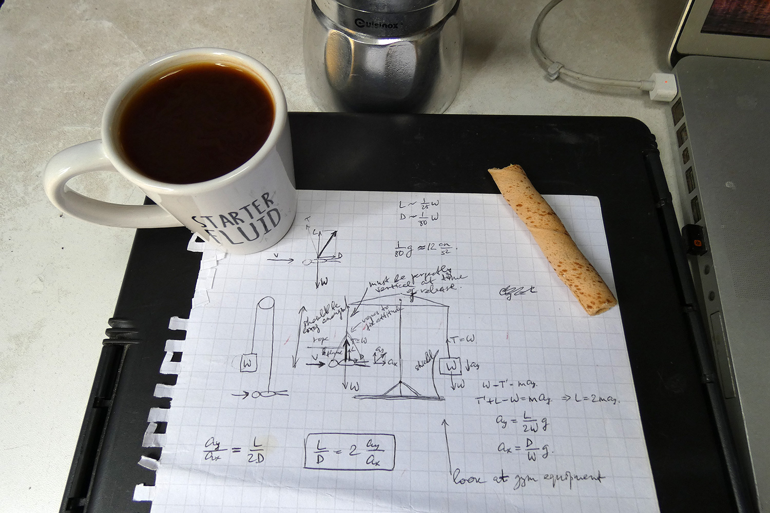

As my 'starter fluid' was being topped off, I found this old idea I totally forgot about: how to measure L/D on the ground, either with real wingsuit/pilot, or a scaled experimental model - all without a wind tunnel!
[inline LDMeasurementWithoutWindtunnel.jpg]
Imagine a WS model suspended from a balance scale, precisely balanced with counterweight, outside on a windy enough day. The model is held in place by horizontal rope as to keep the suspension cable vertical. Then, rope is released. What will happen? Aerodynamic force (with lift and drag components) will push the model at some angle up from equilibrium state. As shown, horizontal and vertical accelerations in the first moments after release will be
ax = g*(D/W)
ay = g*(L/2W)
(this assumes that scales' arm weighs negligibly little compared to model; if it can't be neglected, then the factor 2 will be replaced by a bigger factor that takes both extra weight and moment of inertia; or instead of balance scale, a lightweight pulley can be used as pictured on the left of the scales)
So if we measure these accelerations with a smartphone's accelerometer, we can find out L/D!
L/D = 2ay/ax
If we're only interested in measuring L/D, even accelerometer is not necessary - since ratio ay/ax is equal to the tangent of the angle alpha of initial movement to vertical,
L/D = 2*tan(alpha)
We can also find out absolute values for lift and drag, if weight is known:
L = 2W*(ay/g)
D = W*(ax/g)
And, if we measure wind speed with an anemometer, we can find out Kl, Kd:
Kl = L/V^2
Kd = D/V^2
And from these, sustained horizontal and vertical speeds for this flight mode:
Vxs = Kl/(Kl^2 + Kd^2)^(3/4)
Vys = Kd/(Kl^2 + Kd^2)^(3/4)
And these, for different AoA, will form the polar curve!
How cool is that?! We can do fast-iteration wingsuit improvements right on the ground, and without making rich richer at $1000/hour! All you need is to build a balance that can support the model or even the pilot, and probably ~20mph wind should suffice.
A model can be built using modeling clay and armature like this one:
[inline ModelingArmature.jpg]
With polymer clay, the shape of wings, angles of incidence, body position, etc. can easily be adjusted and studied.
Or, 3D-print a model, make it from several parts and connect them with adjustable armature.
MWGA!

A couple of additional illustrations to show the proper body position and wing angles. Very much like atmonauti, so maybe we can call it "wingmonauti"?
"Lucifer's Dream" was the original name of the wing system, because it had my favorite letters, L and D in it, so I could play this out; but now I like 'The Machine' better. Engineered, not sewed; precise, efficient, fast, lean & mean... true machine!
Nature's beauty and wingsuit science go well together, because wingsuit science is beautiful:
