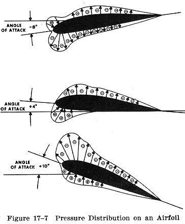

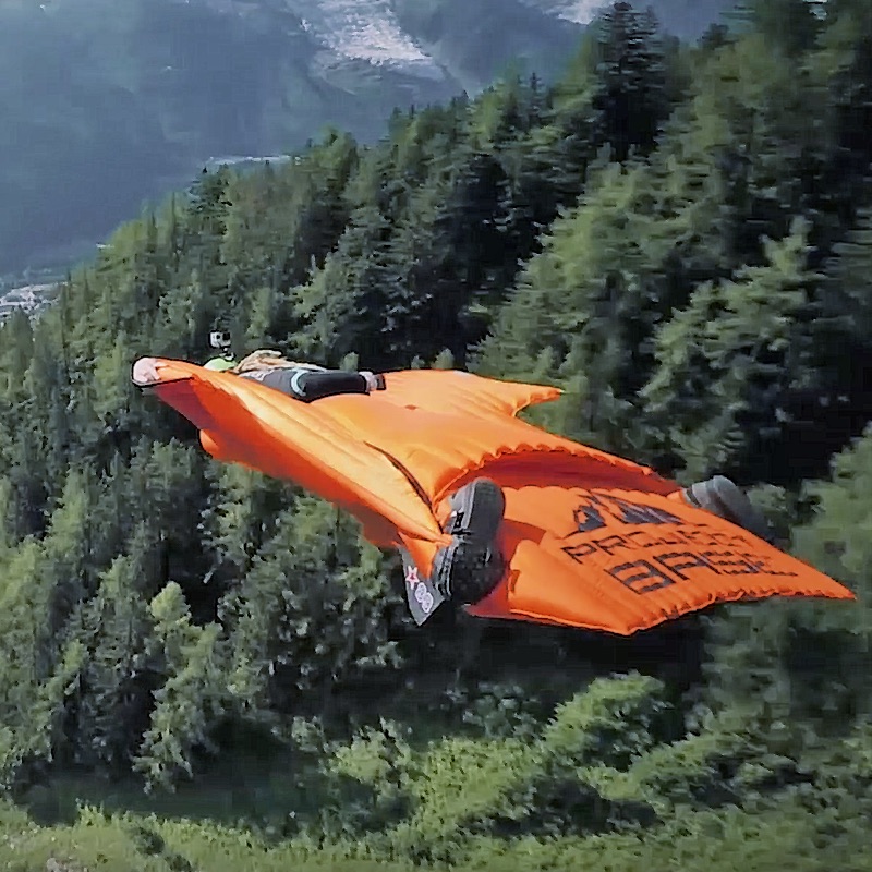

yuri_base 1 #252 October 6, 2018 Pillowing of inflatable mattresses creates a lot of drag on the trailing edge, reduces lift (as lift vector on angled portions of "pillows" is angled to vertical plane), as well as creates additional turbulence on the whole top of the wing. [inline Pillowing.jpg] 'The Machine' with its precise cut, flat span-wise foam wings won't have any pillowing whatsoever and have sharp trailing edges. BOOM! Android+Wear/iOS/Windows apps: L/D Vario, Smart Altimeter, Rockdrop Pro, Wingsuit FAP iOS only: L/D Magic Windows only: WS Studio Quote Share this post Link to post Share on other sites
yuri_base 1 #253 October 6, 2018 BTW, the above picture illustrates another huge problem: shoes sticking out in the airflow, with large flat surfaces trailing in the airflow and creating large areas of negative pressure - lots of parasitic drag! Especially bad with most modern sneakers and hiking shoes where the thick soles flare out to the bottom. (James jumping in slick climbing shoes, the ones for maximum traction, for free climbing, with rounded soles with much smaller surface area is a good idea.) We need to come up with some solution to reduce this drag. Maybe, some kind of ram-inflatable flarings attached to bottom of shoes that won't interfere with exit, but will inflate into a conical shape in flight. At least, with The Machine, stretching the suit shoulders to toes is not necessary (as there's no 'suit' per se), so toes can be pointed as much back as possible, reducing the "footprint" of the shoes.Android+Wear/iOS/Windows apps: L/D Vario, Smart Altimeter, Rockdrop Pro, Wingsuit FAP iOS only: L/D Magic Windows only: WS Studio Quote Share this post Link to post Share on other sites

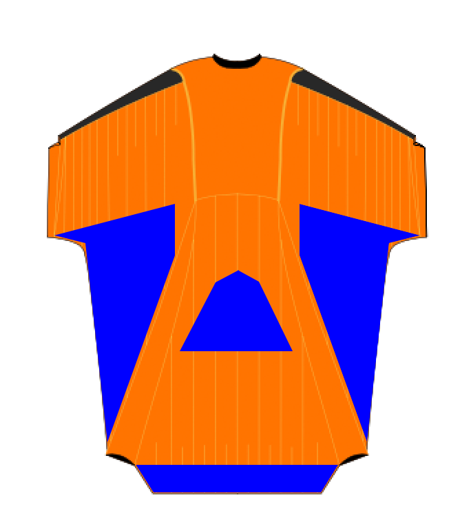

yuri_base 1 #254 October 6, 2018 This approximately illustrates surface area lost (blue) from a mattress to The Machine. The overall wingloading will be higher by a factor of about 1.5 (?). Which means, if Cl and Cd are matched, the speed will be ~20% higher. (Since wingloading and speed in aerodynamic force are in the combination V^2/WL, speed is proportional to square root of wingloading). Mattresses will look like slow boats in the sky compared to the speed boat, The Machine! However, if matching BASE starts is desired, high-Cl airfoils need to be used to compensate for increase in WL (if the ratio Cl/WL stays the same, BASE start is the same), in this case speeds will be comparable. The beauty of the modular wing system that the airfoils can be swapped to meet the desired goals. [inline SurfaceAreaReduction.png] Android+Wear/iOS/Windows apps: L/D Vario, Smart Altimeter, Rockdrop Pro, Wingsuit FAP iOS only: L/D Magic Windows only: WS Studio Quote Share this post Link to post Share on other sites
LeeroyJenkins 3 #255 October 7, 2018 yuri_baseThis approximately illustrates surface area lost (blue) from a mattress to The Machine. The overall wingloading will be higher by a factor of about 1.5 (?). Which means, if Cl and Cd are matched, the speed will be ~20% higher. (Since wingloading and speed in aerodynamic force are in the combination V^2/WL, speed is proportional to square root of wingloading). Mattresses will look like slow boats in the sky compared to the speed boat, The Machine! However, if matching BASE starts is desired, high-Cl airfoils need to be used to compensate for increase in WL (if the ratio Cl/WL stays the same, BASE start is the same), in this case speeds will be comparable. The beauty of the modular wing system that the airfoils can be swapped to meet the desired goals. That suit would not generate as much lift if the coefficients were the same. Quote Share this post Link to post Share on other sites
yuri_base 1 #256 October 7, 2018 LeeroyJenkins***This approximately illustrates surface area lost (blue) from a mattress to The Machine. The overall wingloading will be higher by a factor of about 1.5 (?). Which means, if Cl and Cd are matched, the speed will be ~20% higher. (Since wingloading and speed in aerodynamic force are in the combination V^2/WL, speed is proportional to square root of wingloading). Mattresses will look like slow boats in the sky compared to the speed boat, The Machine! However, if matching BASE starts is desired, high-Cl airfoils need to be used to compensate for increase in WL (if the ratio Cl/WL stays the same, BASE start is the same), in this case speeds will be comparable. The beauty of the modular wing system that the airfoils can be swapped to meet the desired goals. That suit would not generate as much lift if the coefficients were the same. For given weight, in sustained flight lift and drag depend only on L/D (been discussed already: http://www.dropzone.com/cgi-bin/forum/gforum.cgi?post=4896684#4896684), so if we achieve the same L/D as that of a mattress, L and D are the same, it's just the speed will be higher due to higher WL (just like in canopies). And I have all reasons to believe that The Machine will achieve at least 3.0 (but the ultimate goal is even higher L/D). Even if initially The Machine was made as a foam replica of Vampire-2, that's already L/D=2.5. Reducing drag from the body by placing it in "wingmonauti" configuration to relative wind, and having high-lift airfoil profiles for both arm and leg wings, much cleaner flow over the leg wing, and less drag thanks to sharp trailing edges and no pillowing, getting extra 20% should be no brainer. Then, we'll have the lead over WSMs in aerodynamic finesse - the most difficult thing to improve. But the burden to do this is on us, so we need to start doing something, all of us, whatever everybody is best at. We need to start mining our sweet "cryptocurrency" - L/D "coin". We need to change the course of history, we can't sit in this CoW swamp forever...Android+Wear/iOS/Windows apps: L/D Vario, Smart Altimeter, Rockdrop Pro, Wingsuit FAP iOS only: L/D Magic Windows only: WS Studio Quote Share this post Link to post Share on other sites
LeeroyJenkins 3 #257 October 7, 2018 yuri_base******This approximately illustrates surface area lost (blue) from a mattress to The Machine. The overall wingloading will be higher by a factor of about 1.5 (?). Which means, if Cl and Cd are matched, the speed will be ~20% higher. (Since wingloading and speed in aerodynamic force are in the combination V^2/WL, speed is proportional to square root of wingloading). Mattresses will look like slow boats in the sky compared to the speed boat, The Machine! However, if matching BASE starts is desired, high-Cl airfoils need to be used to compensate for increase in WL (if the ratio Cl/WL stays the same, BASE start is the same), in this case speeds will be comparable. The beauty of the modular wing system that the airfoils can be swapped to meet the desired goals. That suit would not generate as much lift if the coefficients were the same. For given weight, in sustained flight lift and drag depend only on L/D (been discussed already: http://www.dropzone.com/cgi-bin/forum/gforum.cgi?post=4896684#4896684), so if we achieve the same L/D as that of a mattress, L and D are the same, it's just the speed will be higher due to higher WL (just like in canopies). And I have all reasons to believe that The Machine will achieve at least 3.0 (but the ultimate goal is even higher L/D). Even if initially The Machine was made as a foam replica of Vampire-2, that's already L/D=2.5. Reducing drag from the body by placing it in "wingmonauti" configuration to relative wind, and having high-lift airfoil profiles for both arm and leg wings, much cleaner flow over the leg wing, and less drag thanks to sharp trailing edges and no pillowing, getting extra 20% should be no brainer. Then, we'll have the lead over WSMs in aerodynamic finesse - the most difficult thing to improve. But the burden to do this is on us, so we need to start doing something, all of us, whatever everybody is best at. We need to start mining our sweet "cryptocurrency" - L/D "coin". We need to change the course of history, we can't sit in this CoW swamp forever... We don't need to do anything because what you want is unrealistic. Also can you posts the equation for lift? Quote Share this post Link to post Share on other sites
