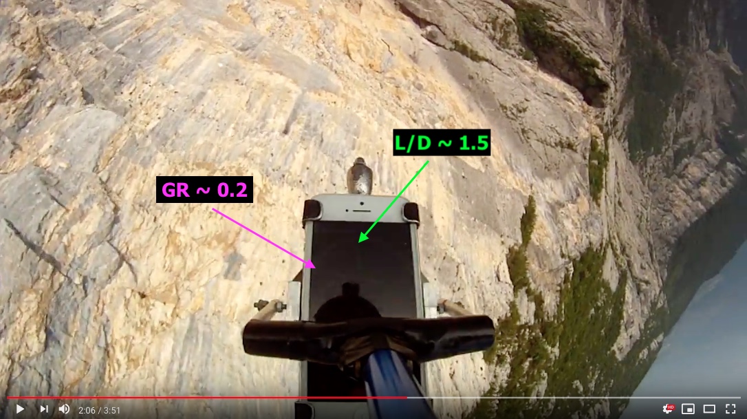

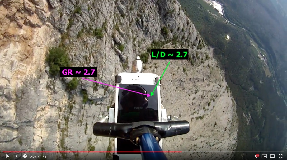

yuri_base 1 #158 September 29, 2018 // https://youtu.be/ee-vE1S-v8s As anyone can see, I'm a very poor mechanical engineer - the vane jitters sideways, which introduces significant acceleration noise from vibrations, I already wrote about these challenges in data filtering. Maybe, a good mechanical engineer will come up with a better vane mount (3D printed even?) that eliminates these parasite vibrations? And become that Solar System-famous (and possibly, Universe-famous) WSV #2? Maybe, a good aerospace engineer will come up with a better vane itself (3D printed even?) that is slick and more aerodynamic (less vibrations from turbulence, too!)? And a belly arm that creates less parasite drag than that trekking pole? And become that Solar System-famous (and possibly, Universe-famous) WSV #3? (that drag from the pole is surprisingly noticeable: without the pole, at Walenstadt, in V4 and exit weight ~250-260lbs, I could fly all the way though the Crack and open at comfortable 40s canopy ride altitude above the PG landing near the soccer field; with the pole, I could not reach that far). Where art thou, good aerospace and mechanical engineers? Chewing in the swamp of WS industry stagnation like CoW?Android+Wear/iOS/Windows apps: L/D Vario, Smart Altimeter, Rockdrop Pro, Wingsuit FAP iOS only: L/D Magic Windows only: WS Studio Quote Share this post Link to post Share on other sites
yuri_base 1 #159 September 29, 2018 yuri_base https://youtu.be/ee-vE1S-v8s This video also demonstrates some major benefits of a vane as a WS instrumentation tool: 1. Vane is already stable pointing into relative wind after less than 2 seconds from BASE exit (let alone skydiving exit): [inline Vane1.jpg] (iphone 5 screen is shit in direct sunlight) It starts measuring L/D right away (~1.5), and it's non-zero from the start, while GR is nearly zero. 2. 15 seconds - L/D is at about max L/D for this flight (2.7), but GR is only 1.7, but growing: [inline Vane2.jpg] 3. 23 seconds: L/D and GR become equal, 2.7. [inline Vane3.jpg] 4. 42 seconds: using milking of speed to convert it into GR (~3.5, the scale is highly nonlinear after 3.0 there) that is higher than L/D: [inline Vane4.jpg] My flight was very poor, I was simply tired of previous 20-30 jumps in a row (I'm not fit, get tired very quickly). That's why my flight didn't have that GR peak, my transition from exit to full flight was mushy, not at constant, max L/D. Also, at about time for my wingloading to have the GR peak (20-25 seconds), it's about time to make a turn which dampens GR. WSE in all their glory. WSE make true flight analysis and instrumentation possible. Let the mass christening of wingsuit community into the new age of wingsuiting begin today! Halle-fucking-lujah! Stop CoWing, start thinking fresh out of the box! I have high hopes that I'm not alone in trying to nudge the WS industry from the stagnation swamp it's been sitting at for the past 12 or so years. Let the Great Wingsuit Revolution of 2018 begin! Let's "Make wingsuiting great again!" (tm) YuriAndroid+Wear/iOS/Windows apps: L/D Vario, Smart Altimeter, Rockdrop Pro, Wingsuit FAP iOS only: L/D Magic Windows only: WS Studio Quote Share this post Link to post Share on other sites

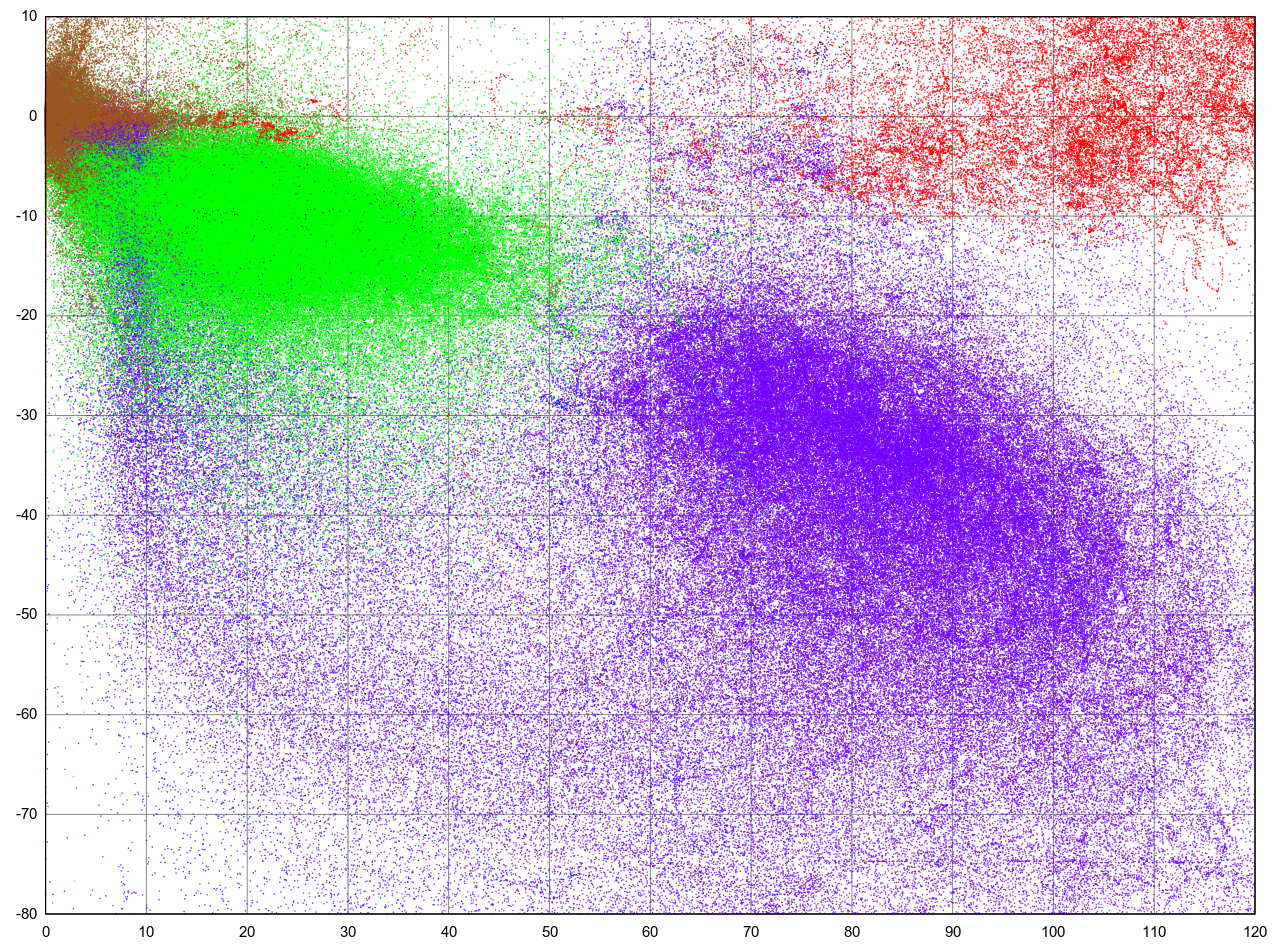

platypii 20 #175 September 30, 2018 Not replying to any particular post, just bringing back the original topic of ws research, and thought I would share some real-world data that might be interesting to people. Data from over 2000 different wingsuit gps tracks (sky and base) plotted as a polar chart. Ground speed on horizontal axis, fallrate on vertical axis (mph). The tracks were classified by flight mode, and the points colored according to: Ground = brown Plane = red Wingsuit = purple Canopy = green [inline baseline-polar.png] This chart helped me understand the typical wingsuit performance envelope a lot better, and was critical in building a tool to automatically recognize different flight modes based on GPS data. BASEline - Wingsuit Flight Computer Quote Share this post Link to post Share on other sites
