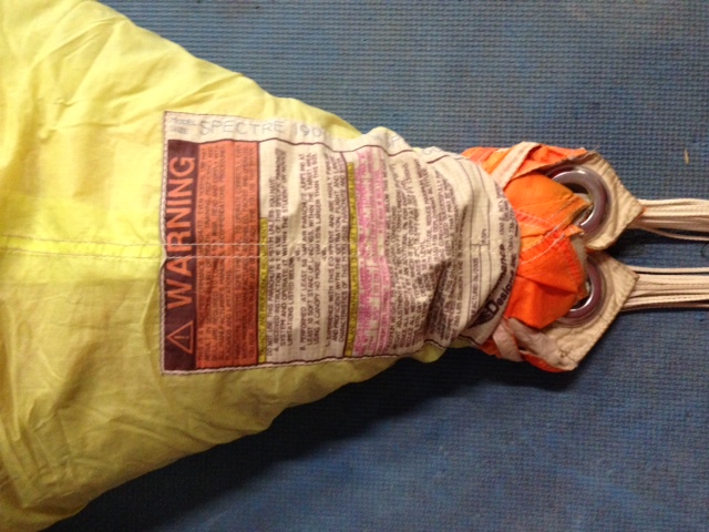

Hooknswoop 19 #12 September 24, 2018 Great questions and good on you for asking them. 1- the idea is that it slows the opening by preventing the canopy from inflating until after the nose unrolls. Debatable if it works or causes off heading openings. Problem is unrolled noses don’t cause hard openings. I believe most hard openings are caused by either not keeping the slider against the slider stops during packing or going too fast when deploying. 2- you want the grommet towards the reserve container. This help to stage the opening process. 3- 18-24 inches. Why not more or less? If you leave less, the lines can hang up on the reserve container on the side that has to wrap around to the bag. This can cause the bag to rotate during deployment. More and you begin to,increase the risk of a line snagging a flap or helmet, or whatever. Semi stowless bags allow you to stow all the limes and do not cause the bag to spin on deployment. They are also easier and faster to pack. What’s not to like? 4- laying the canopy down gently is more about keeping the control lines from getting in front of the nose. Control lines in front of the nose causes line overs. Keep asking questions. If someone doesn’t give you the reasoning behind their answer, ask “why?”. Compare the ‘whys’ and decide for yourself. Often, two different answers can be correct, but one is better for you or your gear. Derek V Quote Share this post Link to post Share on other sites
Maddingo 21 #13 September 24, 2018 Don't basers use nose rolling for on heading openings? They roll 3 cells left and 3 right and expose the middle one. It is actually sticking out so the air hits it before all other cells. I always thought that was the main reason for rolling, not slowing down the deployment. Rolling or pushing the nose inside the pack job has the same effect regarding the slowing down process. The only difference is with rolling u loose 1 minute while with pushing you loose 3 seconds. Quote Share this post Link to post Share on other sites
Hooknswoop 19 #14 September 24, 2018 QuoteDon't basers use nose rolling for on heading openings? I didn’t when I was BASE jumping. The center cell was wide open with 3 cells on each side of the center cell. \\\V/// Is the best I can explain it. Same way reserves are packed. You want a nose first inflation for on-heading performance and to help prevent a line over. If the tail deploys first, the nose can catch a control line, creating a line over. Definitely no rolling of the nose. I don’t roll or stuff the nose when packing a main. Derek V Quote Share this post Link to post Share on other sites

husslr187 24 #17 September 24, 2018 I rolled the nose on my sabre1 to keep it from opening so hard. It seems to stand me up first then open firmly in about 450 feet verses a semi-hard opening in one motion to the point of my feet being eye level in front of me for about 200 feet. I do have a pocket slider for it as well. Rolling the nose on my sabre2 is unnecessary. The nose opening are smaller and doesn't fill as quickly and it opens between 6-800 feet Quote Share this post Link to post Share on other sites
