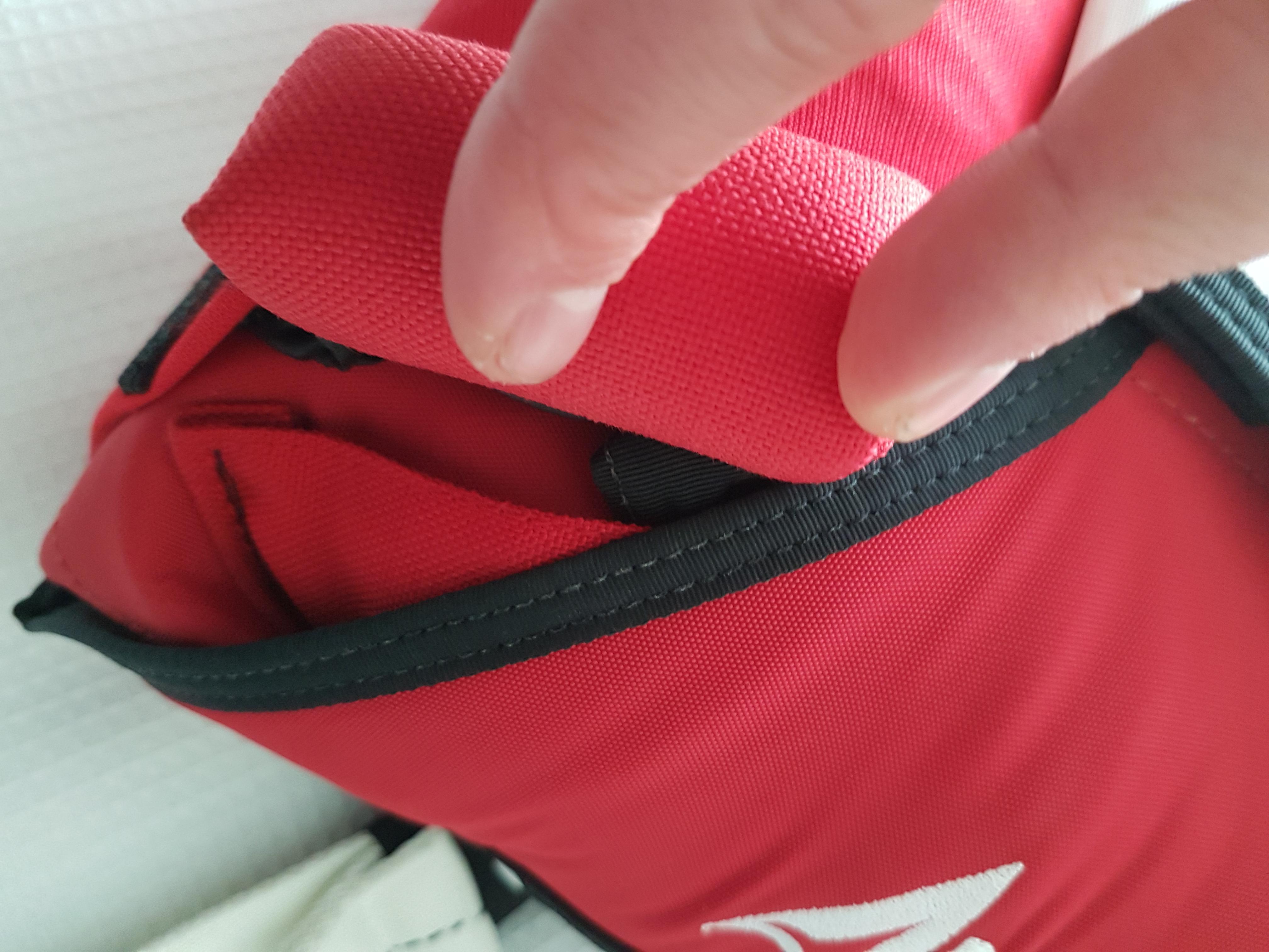

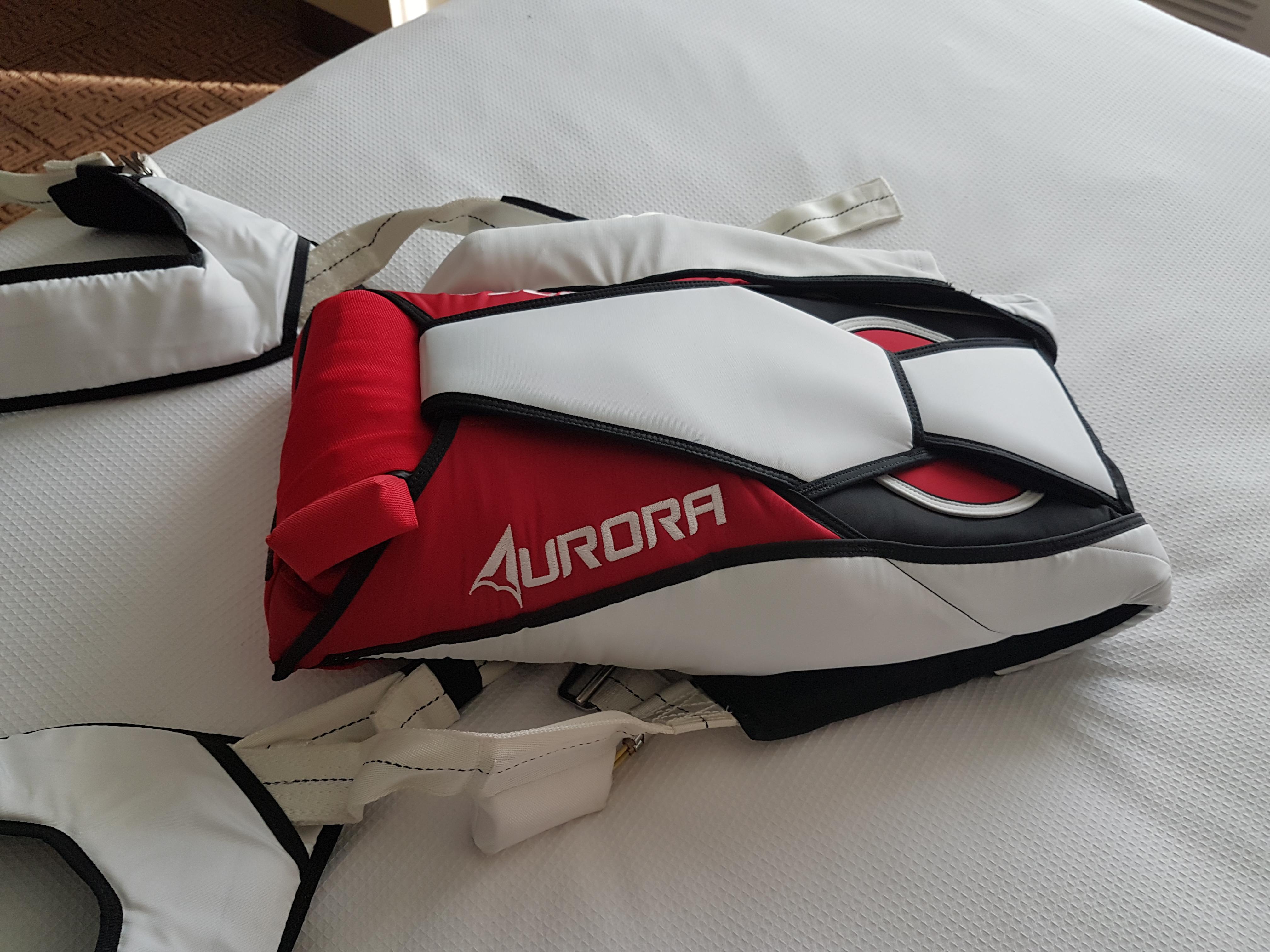

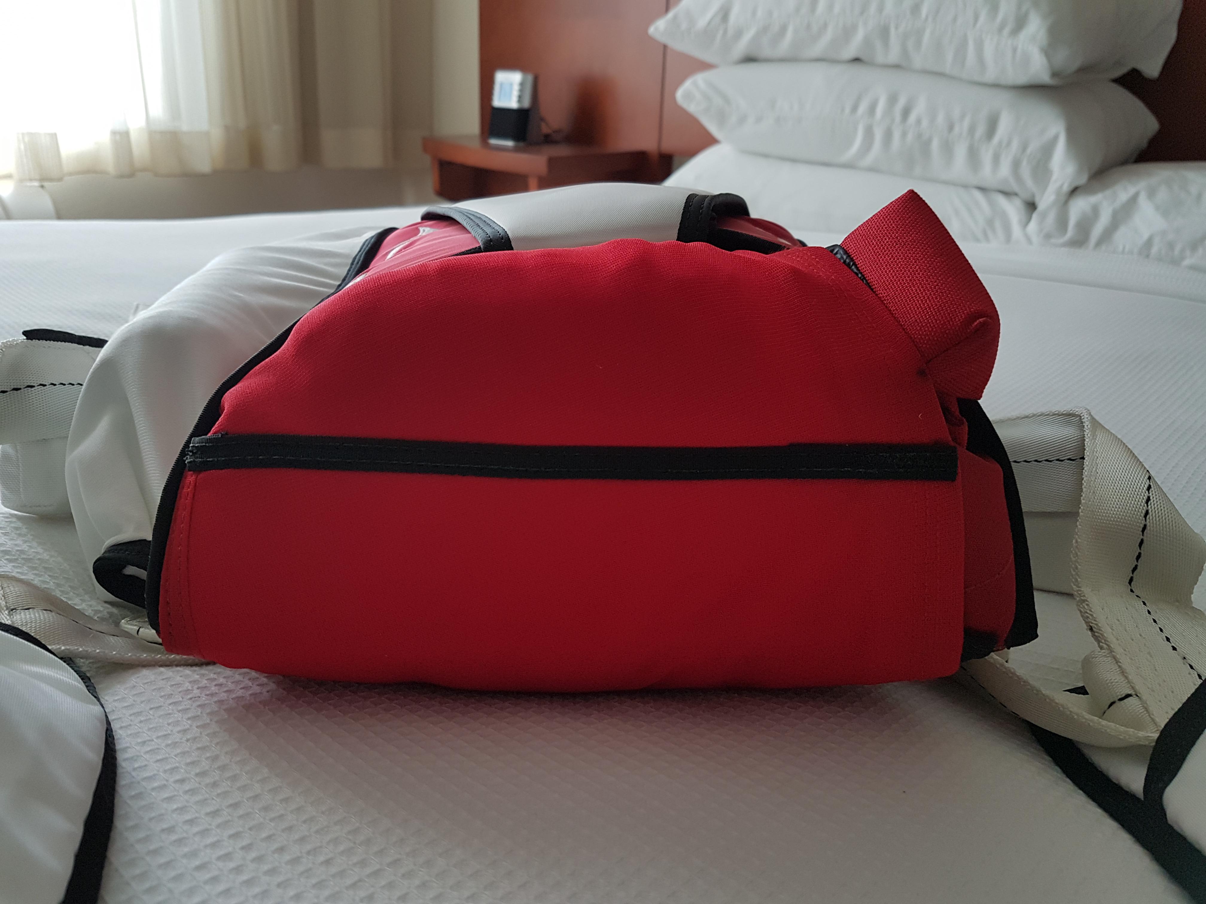

verticalflyer 11 #11 May 2, 2019 On 4/26/2019 at 7:41 PM, urowolf said: Put about 50 jumps on Aurora. Excellent rig for WS. Well thought out. Very comfortable and light (no articulated harness - less metal, may be the material is lighter as well). Love the long and flat concept, very easy to reach hackey. The giant PC compartment is very elastic. Makes me worry a bit about the PC coming out prematurely. I love the mechanics of all in line DBag and corner less container. Looks and feels great:). I got my rigger to split the BOC into 2 with a simple stitch line and add a bridle cover, I can now select either a top BOC pouch or bottom, as I also was concerned about loos BOC. works nicely now, cost all of $20 and about 30 mins work, images attached, several friends have now made the mod also. 1 Quote Share this post Link to post Share on other sites
birdynamnam 28 #12 May 2, 2019 that's one solution. I pack it "around the corner" against my back. The pouch goes all the way back there, It sits well and highly protected offcourse and it is still easy reachable be it with small or large wingsuits Quote Share this post Link to post Share on other sites

verticalflyer 11 #14 May 6, 2019 On 5/2/2019 at 3:29 PM, birdynamnam said: that's one solution. I pack it "around the corner" against my back. The pouch goes all the way back there, It sits well and highly protected offcourse and it is still easy reachable be it with small or large wingsuits Tried that but still way too easy to pull out and catch in aircraft. Quote Share this post Link to post Share on other sites

kleggo 145 #18 May 28, 2019 On 5/2/2019 at 12:31 PM, verticalflyer said: I got my rigger to split the BOC into 2 with a simple stitch line and add a bridle cover, I can now select either a top BOC pouch or bottom, as I also was concerned about loos BOC. works nicely now, cost all of $20 and about 30 mins work, images attached, several friends have now made the mod also. Interesting. Thanks for posting up the images. I'm considering buying a new rig JUST to have the main pud lower on my back for WS. Quote Share this post Link to post Share on other sites

richoH 6 #23 June 12, 2019 On 5/2/2019 at 12:31 PM, verticalflyer said: I got my rigger to split the BOC into 2 with a simple stitch line and add a bridle cover, I can now select either a top BOC pouch or bottom, as I also was concerned about loos BOC. works nicely now, cost all of $20 and about 30 mins work, images attached, several friends have now made the mod also. What's going on on the left hand side of your container?? Quote Share this post Link to post Share on other sites
meat.missile 25 #24 June 13, 2019 On 6/12/2019 at 11:46 PM, richoH said: What's going on on the left hand side of your container?? great question Quote Share this post Link to post Share on other sites
