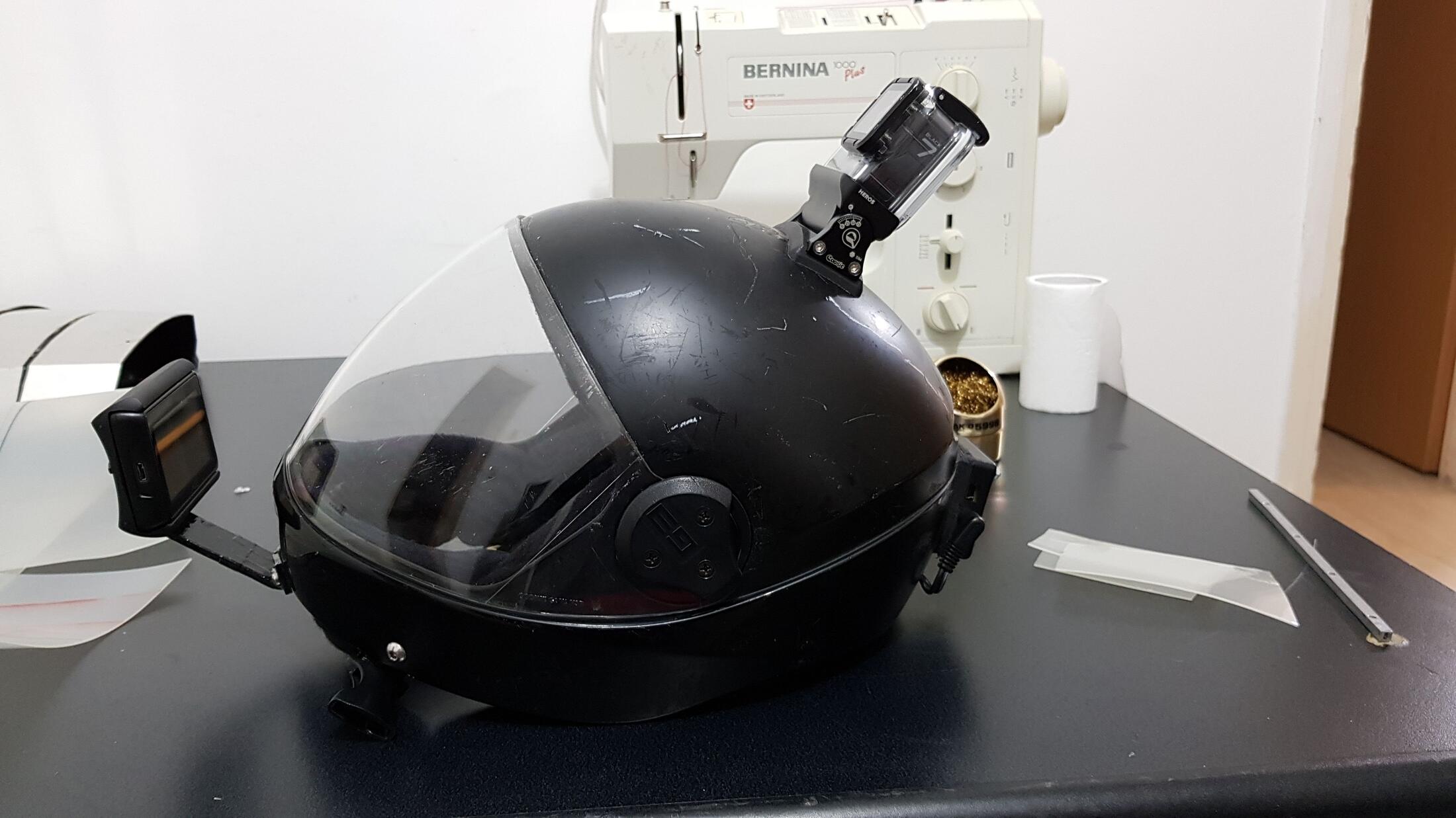

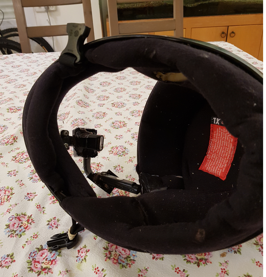

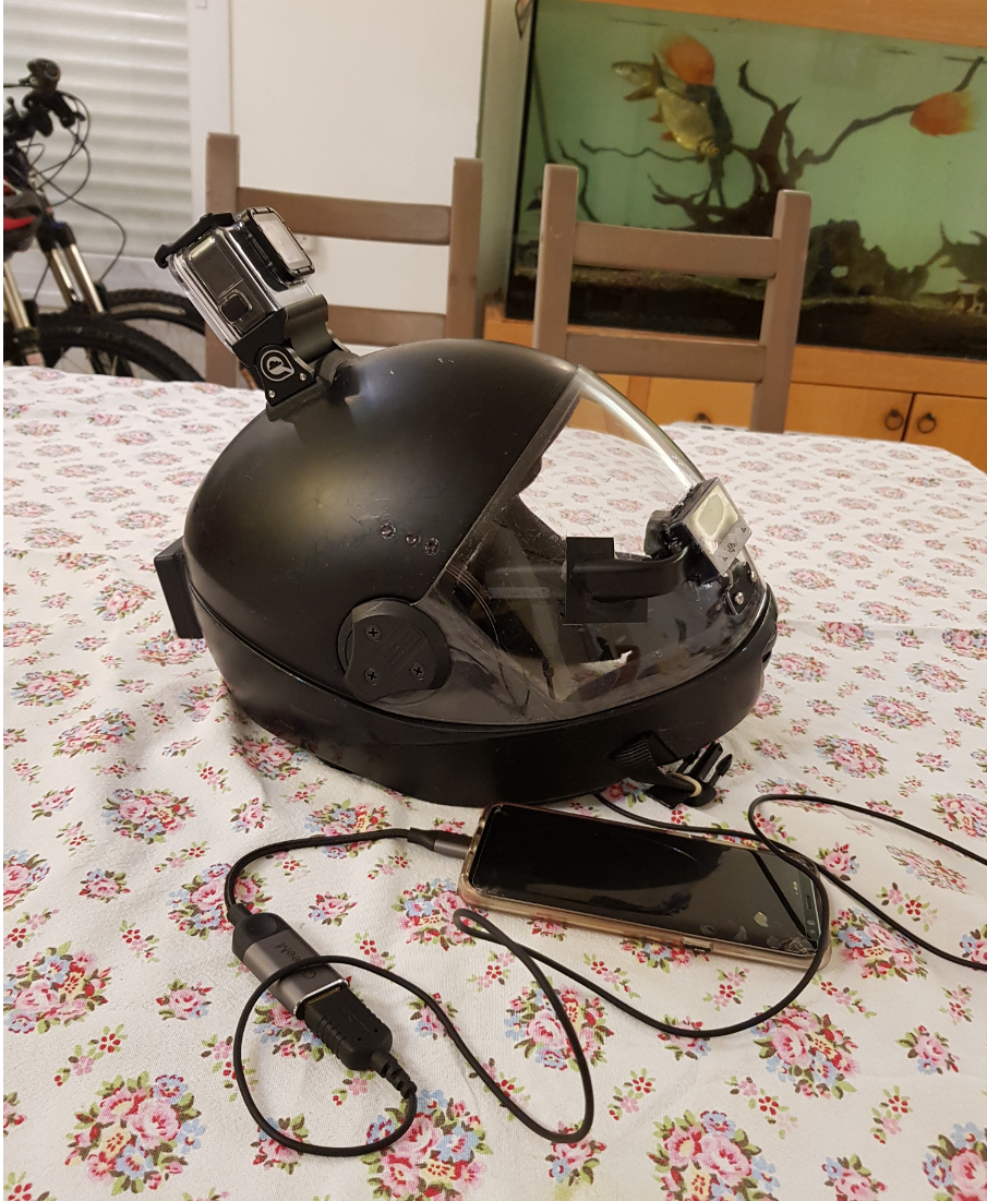

Gideon Yampolsky 38 #18 January 15, 2020 Photos of helmet with Vufine HUD installed and connected to smartphone. The display of application running on phone is mirrored to Vufine. A lot of work to properly install it in helmet. 1 Quote Share this post Link to post Share on other sites

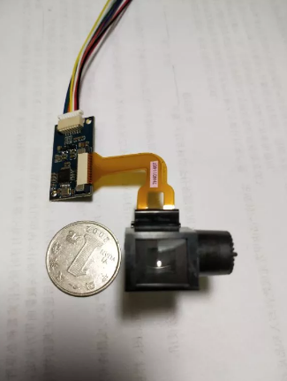

the.Legend 55 #23 June 27, 2021 (edited) My attempt at something similar. Really basic code on Arduino Zero + some LEDs It supposed to show horizontal speed and heading (in degrees) but there's no GPS signal in the apartment Pros: * Cheap and really easy to build * Numbers on LED are kinda readable because it's standard LED numbers font (although it needs some time to get used to) * Easy to program new display information in basic C code * Numbers are readable even in bright light * Size could be reduced by 50% easily (most of the space is used by battery and its charger) Cons: * Numbers on LED are kinda readable (although it needs some time to get used to) Dry tests on the ground so far, not jumped this thing yet (want to reduce its size first) I'm looking for good alternative for LED so it would obscure even less view, but here I'm facing the problem with finding something readable at close range. I thought about monocle displays because they use standard AV input and thus may be used with Arduino too. @Gideon Yampolsky could you please elaborate on what exactly was inconvenient with Vufine display? gps_Full HD 1080p_(1).mp4Fetching info... Edited June 27, 2021 by the.Legend 1 Quote Share this post Link to post Share on other sites
lyosha 50 #24 June 28, 2021 The folks at AON2 are hard at work on this. https://www.facebook.com/aonsquared Quote Share this post Link to post Share on other sites
the.Legend 55 #25 June 28, 2021 Another alternative is to use transparent OLED display. Surprisingly, there's a product with everything on-board except GPS: http://www.lilygo.cn/prod_view.aspx?TypeId=50032&Id=1354&FId=t3:50032:3 Battery, OLED, drivers - everything is already assembled. It's based on ESP32 and is fully programmable, so adding GPS module won't be that difficult. I'm waiting for the package delivery (in about one month because from China) and will share the test results Quote Share this post Link to post Share on other sites
