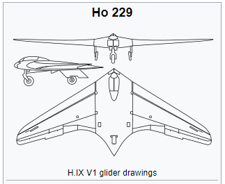

Soude 0 #1 Posted December 14, 2019 Hi I'm student of aviation college and I want to design a wingsuit as a project I will so pleasure if there is any body to do this project I need some information about WS that I can't find them in articles 1. I need some real pictures for one WS from different angle 2. Is there anybody know about aerodynamic design of WS? Airfoil number? Pitching moment of airfoil? 3. What's your opinion of I want to change the classic design of WS and new suit look like "Horten H O 229"? Is it a good idea? Quote Share this post Link to post Share on other sites

SethInMI 174 #4 December 16, 2019 On 12/14/2019 at 9:25 AM, Soude said: new suit look like "Horten H O 229"? Is it a good idea? Where is @gisellemartins Soude, there was a long discussion on this forum about 7 years ago about if it is possible to design wingsuits with large enough wings to allow soaring (like a hang glider). The answer is it is not possible for many reasons. You can search for "JetMan" to see a person flying under a rigid wing. 1 Quote Share this post Link to post Share on other sites

Skwrl 56 #9 February 5, 2020 On 12/16/2019 at 8:58 AM, SethInMI said: Where is @gisellemartins Soude, there was a long discussion on this forum about 7 years ago about if it is possible to design wingsuits with large enough wings to allow soaring (like a hang glider). The answer is it is not possible for many reasons. You can search for "JetMan" to see a person flying under a rigid wing. There's a name that I haven't heard in a long time. What a nut job she was. As I said back in 2011 (or whenever that was), the issue here is induced drag. Unless you add a rigid frame, your arms won't be able to hold the wing in this shape for flight. And once you add a rigid frame, it's not a wingsuit, it's... something else. Quote Share this post Link to post Share on other sites

Mr.B 0 #12 March 22, 2020 On 12/14/2019 at 3:25 PM, Soude said: Hi I'm student of aviation college and I want to design a wingsuit as a project I will so pleasure if there is any body to do this project I need some information about WS that I can't find them in articles 1. I need some real pictures for one WS from different angle 2. Is there anybody know about aerodynamic design of WS? Airfoil number? Pitching moment of airfoil? 3. What's your opinion of I want to change the classic design of WS and new suit look like "Horten H O 229"? Is it a good idea? Sounds like a fun project to dive into. My knowledge of wingsuit design is very limited (I only fly them ), but a friend of mine is doing his own tracksuits and wingsuits in his garage and then basejumping/flying them himself... with no actual aviation education. So for a motivated individual willing to learn, it is not impossible as some people try to make it look... Even more so doable if it's a student project not a commercial one, where I assume no one will actually fly the thing from the plane anyway. My friend website is here: http://www.rbaseg.eu/ You can find contact information there. He is usually very open to sharing knowledge, and as far as I know, he is right now building another suit, so maybe he can snap and share some photos from different stages of development. As for suit looking like Horten H O 229... I think Tonysuits made at some point a suit looking very similar to that (just arm wing - no or very small leg wing). Can't seem to find a photo of the suit anywhere online now, but from my memory it looked similar. It was not a mainstream product, but I remember that a guy flying it, made a very good score (speed wise) during one of wingsuit BASE competitions in Norway few years back. But probably there is a reason (or multiple of them) why the suit never got into mass production. But the idea has been tried already. Good luck! cheers Quote Share this post Link to post Share on other sites
johnmatrix 21 #13 March 27, 2020 On 3/22/2020 at 7:34 PM, Mr.B said: I think Tonysuits made at some point a suit looking very similar to that (just arm wing - no or very small leg wing). Can't seem to find a photo of the suit anywhere online now, but from my memory it looked similar. It was not a mainstream product, but I remember that a guy flying it, made a very good score (speed wise) during one of wingsuit BASE competitions in Norway few years back. It sounds like you are talking about the suit Yegor Orlow flew when he won in the World BASE Race 2016. It had a big arm wing but the tail was more like a Phantom, cut up above the ground. I think the arm root also protruded below the feet so it almost looked like fangs coming down. I was there at the time he was jumping it and remember watching him looking at the tailwing in flight and thinking it must have been just a trick of my eyes. From memory it was a test design from some time ago that had been left alone, TonySuits dubbed it the 'FlickTail' afterwards and I am sure they produced an article on it for Facebook but I can't find it now. Very interesting design and totally changed how I thought about it all. 1 Quote Share this post Link to post Share on other sites
