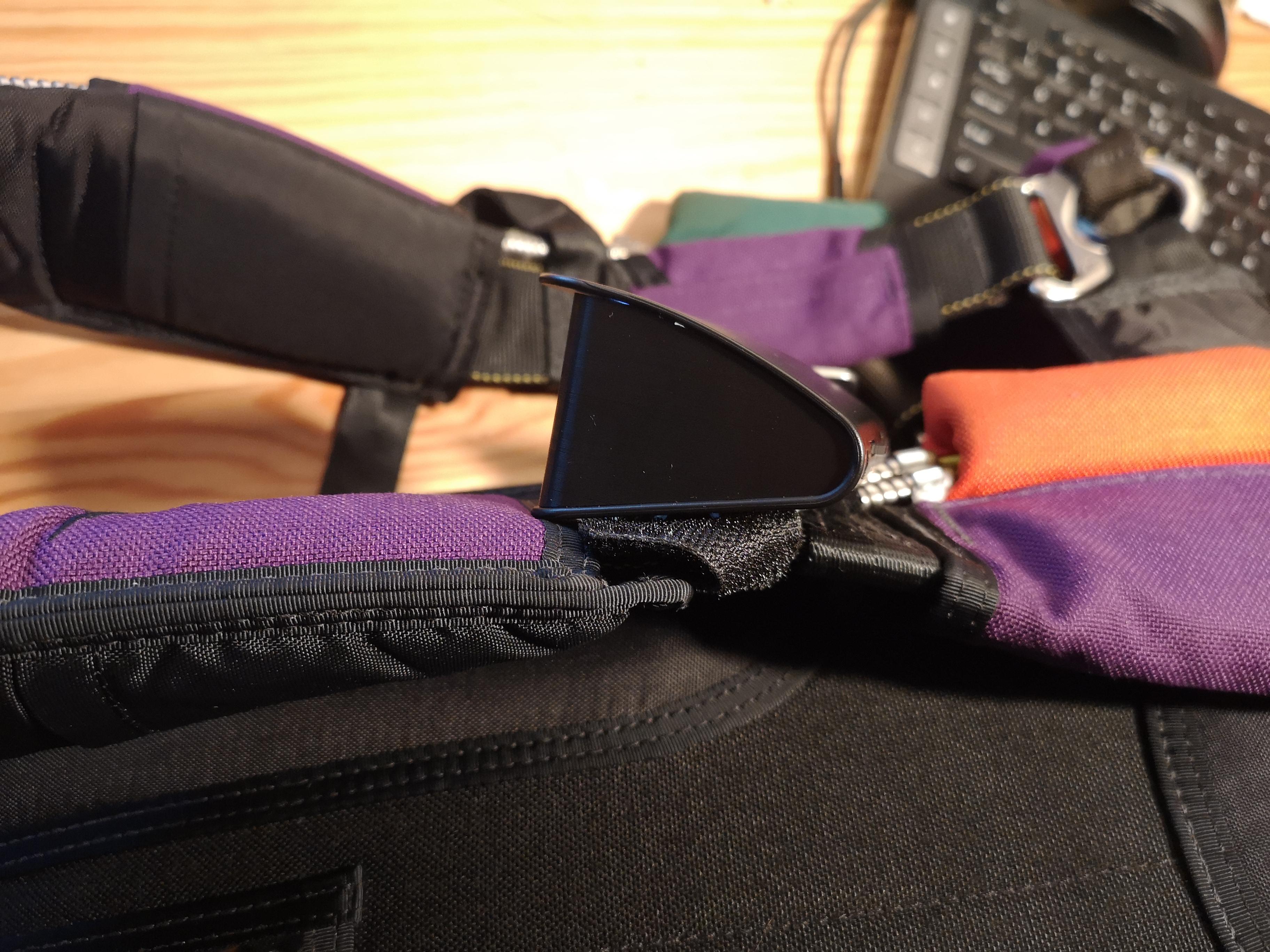

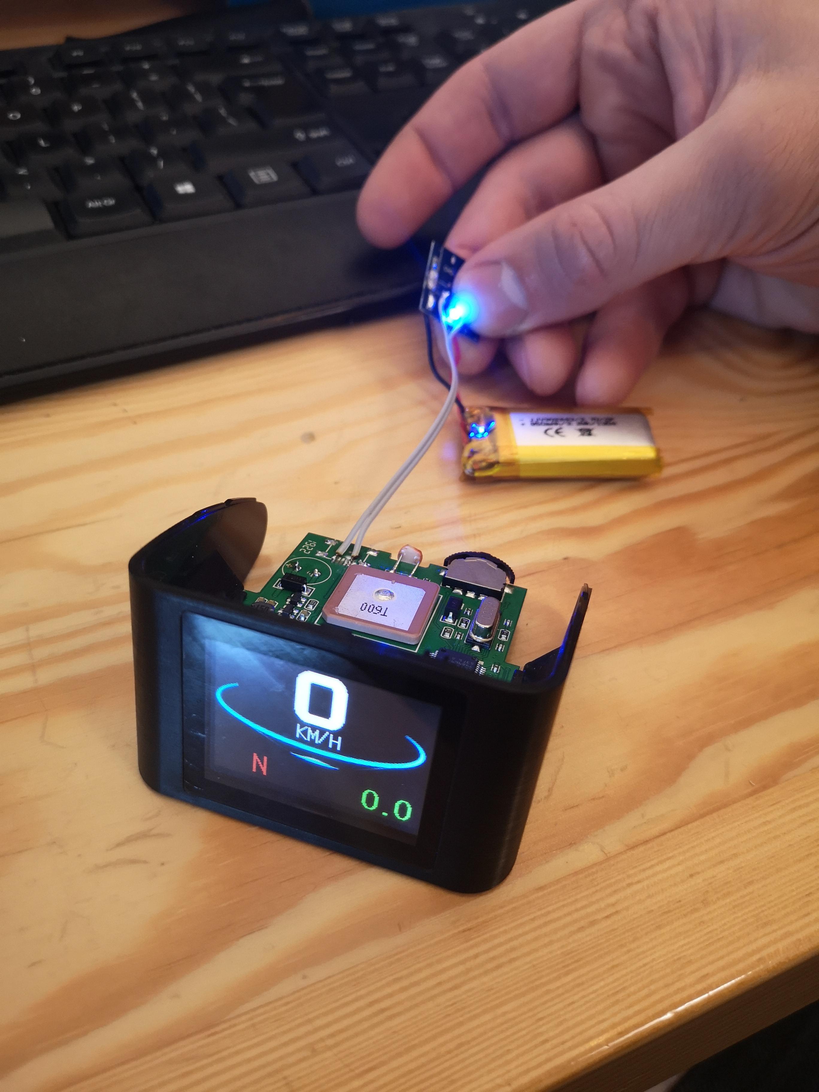

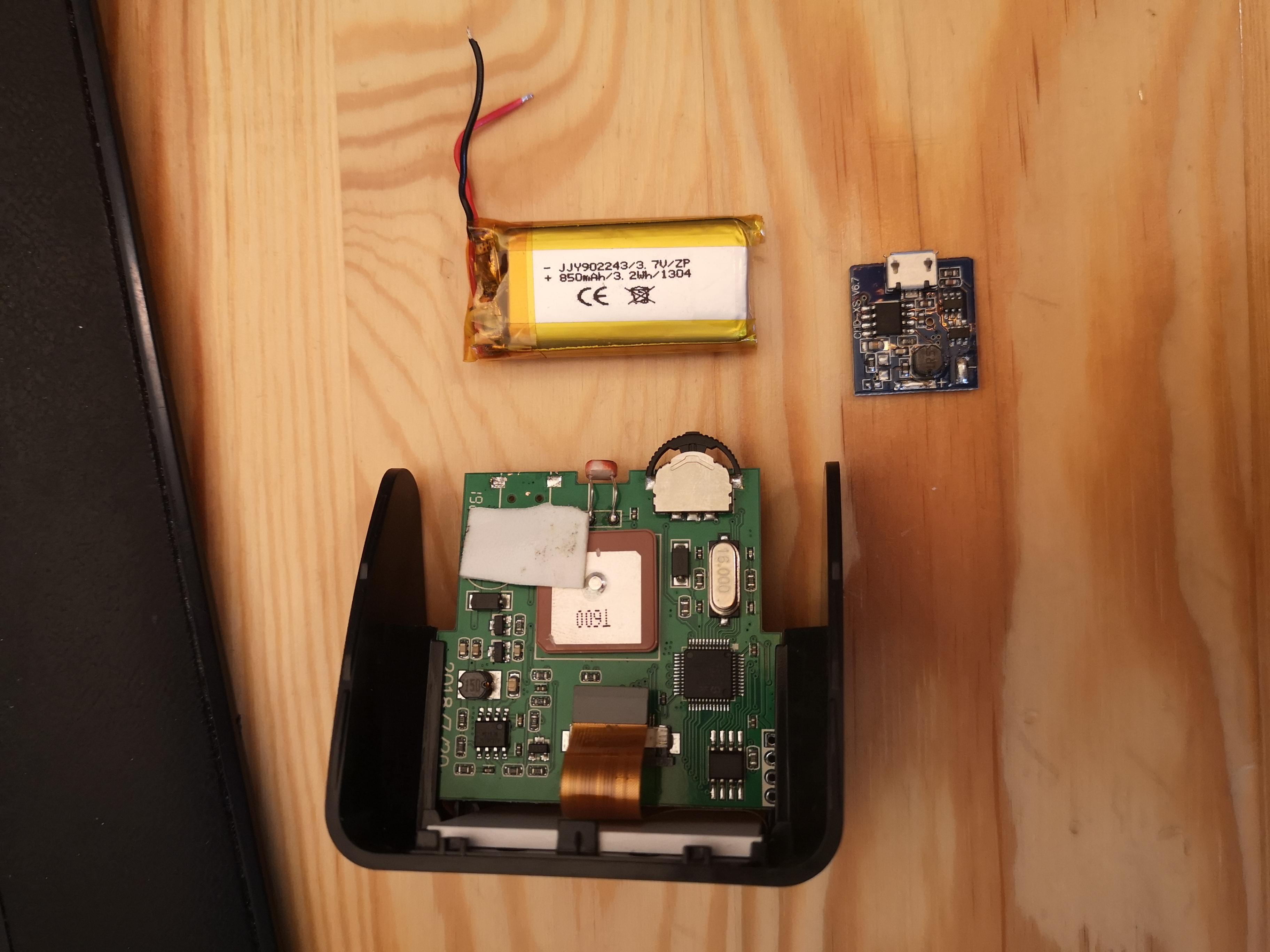

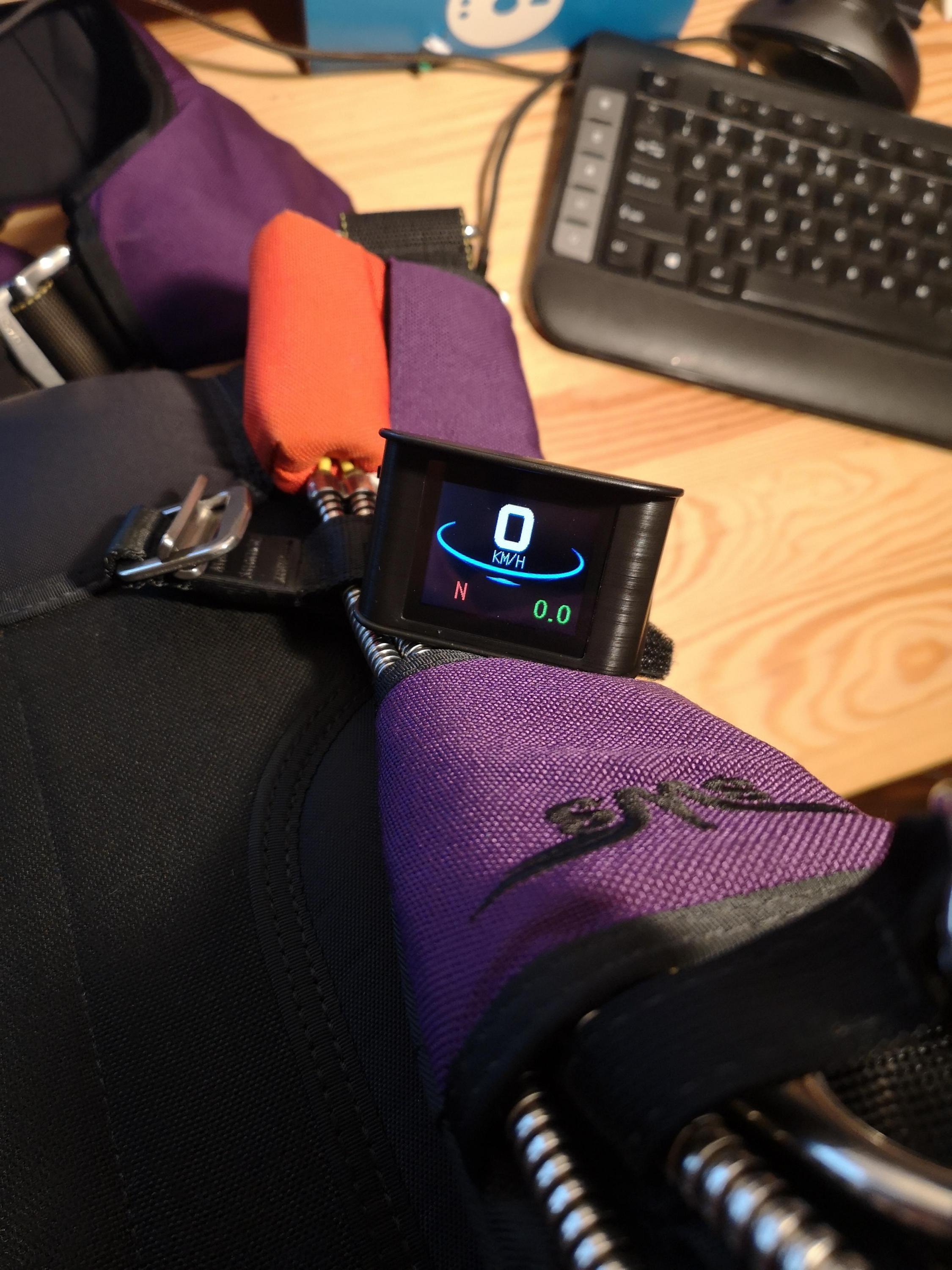

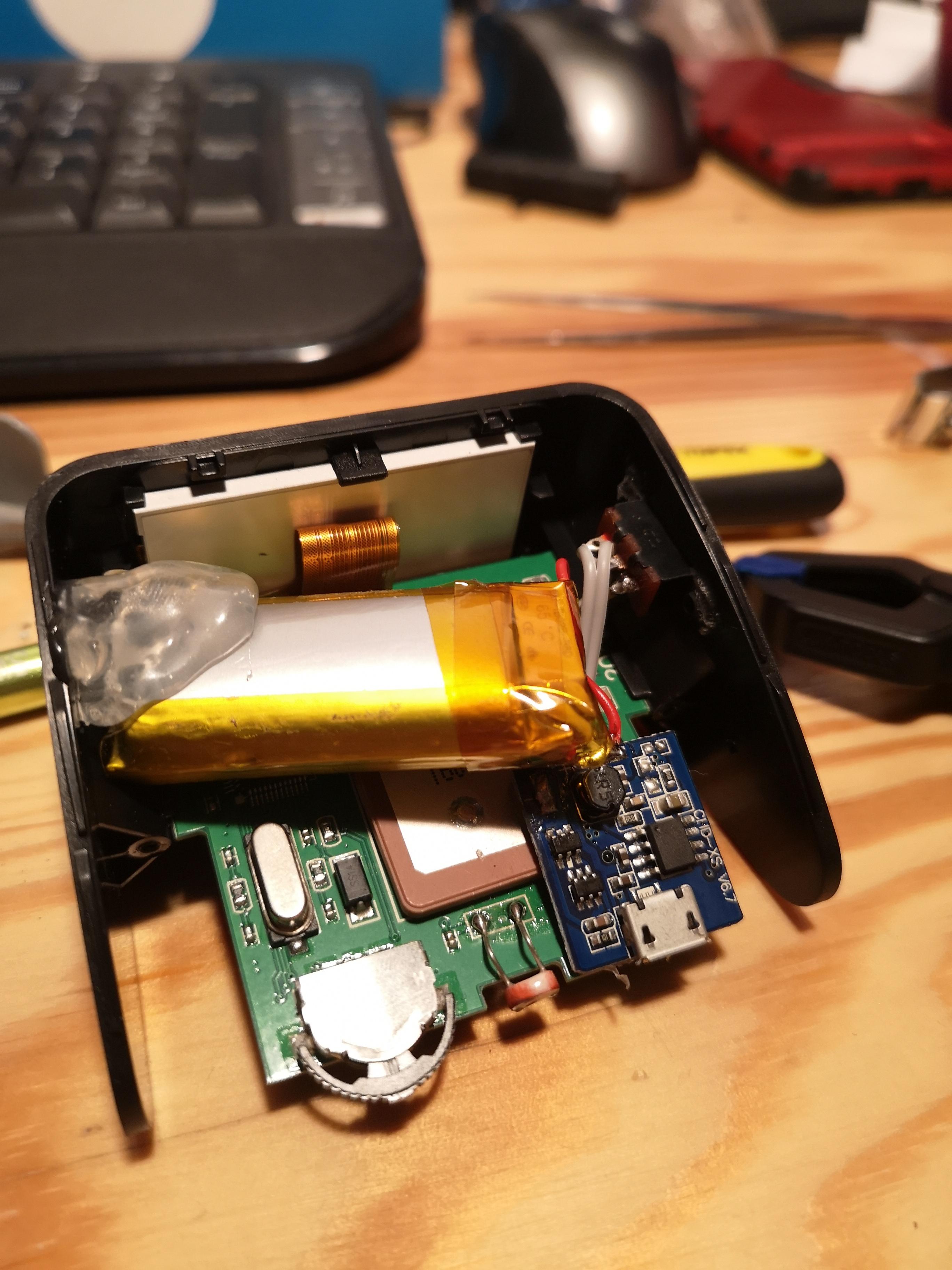

the.Legend 55 #1 Posted September 16, 2020 A quick project for tracking basic data during flight. This is a garage project I made out of own curiosity. Not tested in flight yet, if you decide to do it you're doing it at your own risk. There are advanced solutions on the market like Dekunu One or Aon X2 and if you can afford them I encourage you to use professionally made equipment. You'd need: * Car GPS speedometer (I used this one because its shape and size are already almost snag-free: https://www.aliexpress.com/item/4000265066382.html * Powerbank (with least capacity and smallest size possible - in the prototype this one was used: https://www.aliexpress.com/item/32945597181.html ) * 850 mAh battery (ideally 2000 mAh, but unlikely they'll fit inside the case) * Small switch Assembly is pretty straightforward: unsolder USB ports on both GPS and powerbank, solder switch and battery. Additionally I flipped the capacitor (it's under white tape on the first photo) - put it on the opposite site of the board to give some room for powerbank's charger. The device is mounted on a rig using velcro strap with a loop. So far I tested it on the ground on a bike and the speed is pretty accurate - +/- 1 km/h to what smartphone GPS shows Even with 850 mAh battery the device help up for around 8-10 hours (screen constantly on) which is quite impressed actually. Talking about the battery - attentive reader might notice that it got swollen - probably because powerbank's changer is for 2000 mAh, while battery is 850 mAh. That's a critical flaw because swollen battery has high risk of explosion as pressure changes during climb to the altitude. If I ever decide to use it for actual tests, the batteries will be replaced with non-chargeable lithium batteries just like in audibles (powerbank's module would still nicely convert that into a constant 5V supply). Meanwhile I'm doing some more research to find safe chargeable batteries. Now, what this thing can do: * Display current ground speed (both metric and those other, inferior units). Speed alarm can be set at as high as 200 km/h, so I'd assume device can measure at lease that much * Display one of 8 directions ( N/NE/E/SE and so on) - yeah, it's pretty basic, but better than nothing * Display distance covered, accuracy 100m * Display few other stats, but those are useless for WS flying * Oh, yeah, you can change colors Again, this is a garage project. I'm only sharing the fruits of my curiosity and taking no responsibility for what you might do with it. 6 Quote Share this post Link to post Share on other sites
the.Legend 55 #2 November 7, 2020 Quick update: battery has been replaced with other, more reliable and I was able to test it today. Long story short - the unit didn't work as well as I'd expected: it was perfectly fine during the climb, showing both ground speed and distance, but during the jump when altitude drops quickly it just stops processing all the readings. Under the canopy it works again, but the moment you do any kind of dive it stops reading again for a second. Well, it wasn't designed for skydiving after all, so nothing to complain about. At least I was able to measure my ground speed under the canopy, so it could be used for some basic canopy piloting drills, but nothing more than that. P.S. Turns out the plane travels in circles roughly 70 km at ~190km/h to climb to a 4k 2 Quote Share this post Link to post Share on other sites

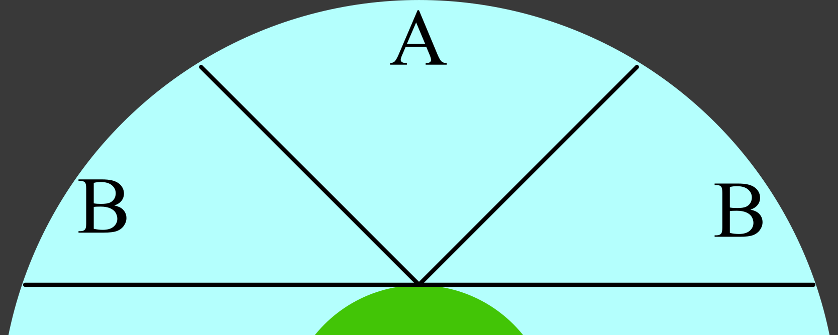

platypii 20 #8 November 20, 2020 When I said "satellites are mostly near the horizon" I meant that statistically at any given time, you are more likely to have satellites off to the side, than overhead. And If you're trying to use triangulation to measure height and vertical speed... that's going to be less accurate without satellites overhead. Geometrically it's a fact that they are more likely to be near the horizon than overhead. Here's why. If you draw a line extending out 45 degrees above the horizon, then the area of sky "above" you is much smaller than the area to the sides. I get a ratio of more than 2:1 "near the horizon" vs "above" at GPS altitudes. Picture is drawn to scale. I will say though, I expected a bigger ratio. But because GPS orbits are actually quite high, this is less of a factor than if they were in lower orbit. Quote Share this post Link to post Share on other sites
nwt 131 #9 November 23, 2020 On 11/20/2020 at 4:52 PM, platypii said: When I said "satellites are mostly near the horizon" I meant that statistically at any given time, you are more likely to have satellites off to the side, than overhead. And If you're trying to use triangulation to measure height and vertical speed... that's going to be less accurate without satellites overhead. Geometrically it's a fact that they are more likely to be near the horizon than overhead. Here's why. If you draw a line extending out 45 degrees above the horizon, then the area of sky "above" you is much smaller than the area to the sides. I get a ratio of more than 2:1 "near the horizon" vs "above" at GPS altitudes. Picture is drawn to scale. I will say though, I expected a bigger ratio. But because GPS orbits are actually quite high, this is less of a factor than if they were in lower orbit. Interesting. So the 2:1 ratio you mention is the area of region B to area of region A in your diagram? Or the volumes? Do you have a source for this actually being a contributing factor for the worse accuracy in vertical? Quote Share this post Link to post Share on other sites
