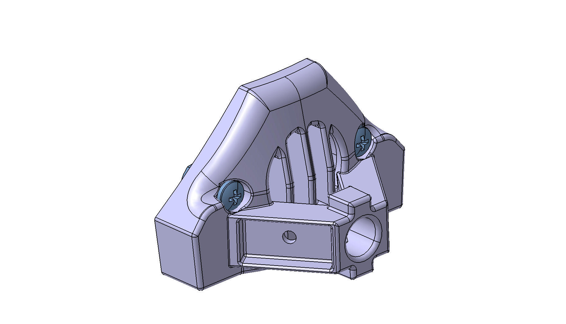

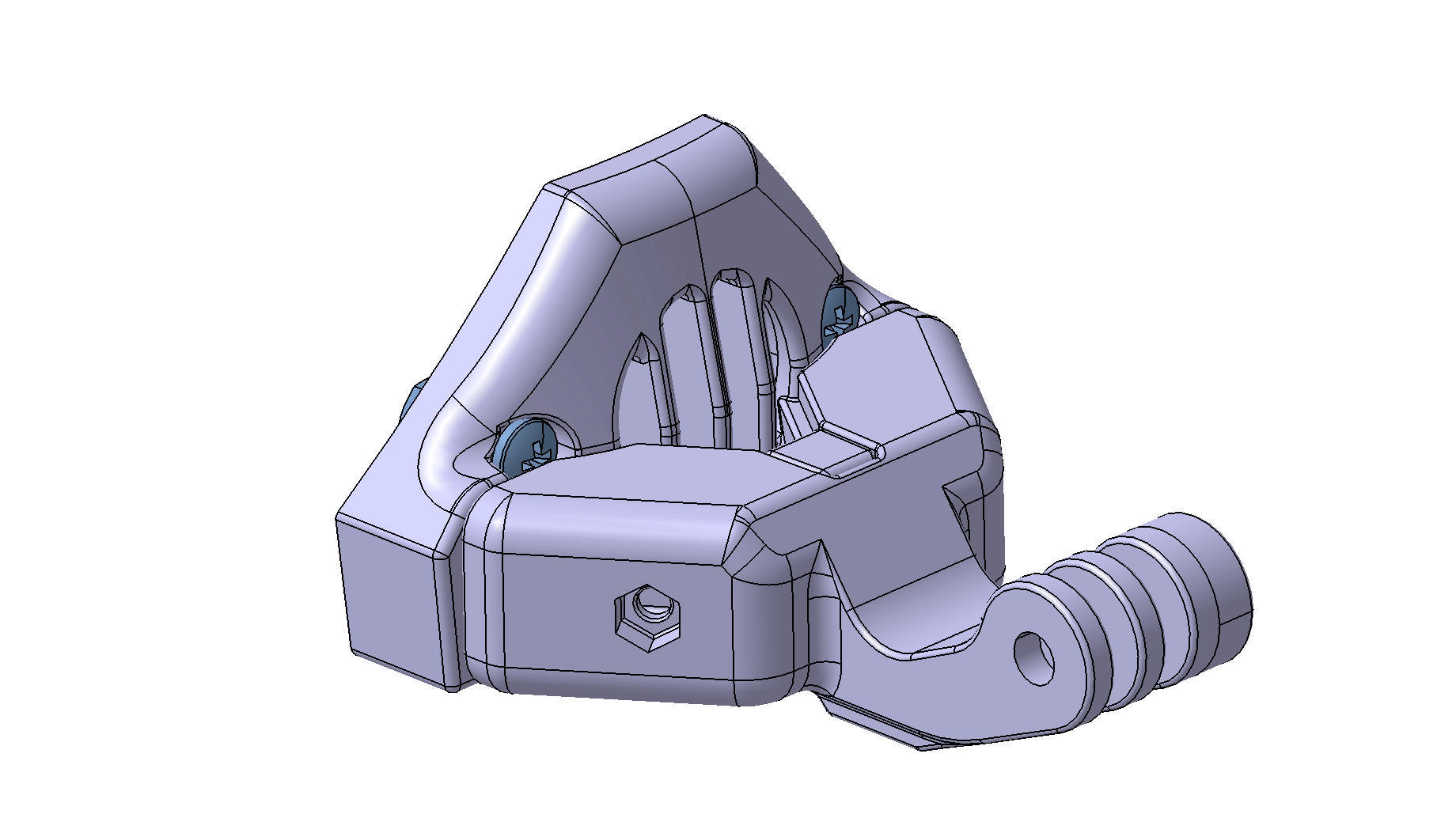

Phantom helmet Vmag mount
I'm dropping this here in case people would like to fabricate them.
Compatible with the Vmag system except for the magnets hole
The mount use the existing holes in the helmet
3D printing process = HP PA 12 (MJF)
www.hubs.com
Screws:
1x Socket head cap screw M5-0.8 x 20mm
1x Nut M5x0.8
2x Button head #6-32 x 1/2in
2x Nut #6-32
4x Countersunk screw M3-0.5 x 8mm
4x Nut M3-0.5
Ebay N52 magnet 20x10x4mm with 4mm hole
You need the poles to be inverted for them to work.
I had to invert 1 side and drill a countersunk using a diamond bit
Phantom.stl Vmag camera short.stl
