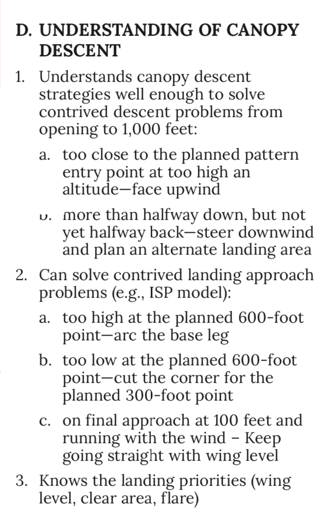

it is in IRM ( page 26 ) and also in SIM .
That is essentially a visual exercise to gauge proximity. If you are halfway to the ground (from your opening altitude) and not at least halfway back to the landing area (horizontally from your deployment point) the suggestion is to head that way (stated "steer downwind") and look for an alternate landing area in case you don't make it.

This is really basic stuff that should be covered in any FJC. A simple method to avoid  getting too low before picking an alternate landing area in case of a bad spot.
Example; pattern entry is at 1000’ and every student should know approximately where the planned pattern entry point is. Under canopy at 4000’, look down and figure out your position, look at pattern entry point and pick a spot about 1/2 way between.
4000-1000=3000/2=1500’. So, at 2500’, if not at or well past the 1/2 point, pick out an alternate landing.
