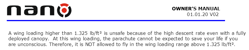

tabouare 25 #7 January 12, 2023 I've only ever considered those 2 low pack volume reserves PD Optimum Icarus Nano Be aware that the Nano has a wingloading limit so too much pies is a no no Quote Share this post Link to post Share on other sites

riggerrob 643 #15 January 19, 2023 PD Optimum was certified under a one-time FAA waiver for a hands-off descent rate of "more than X feet per second." PD talked the FAA into accepting a flared landing as an alternative way to reduce rate-of-descent. A member of the PIA standards committee told me that will never happen again. PIA worries that an AAD will save the jumpers' life, but then he will be badly injured during an unconscious un-flared landing. So you might "legally" load a PD Optimum reserve more than 1.3 pounds per square foot, but the laws of man must bow to the laws of physics. 2 Quote Share this post Link to post Share on other sites
shadeland 5 #16 January 21, 2023 On 1/19/2023 at 8:49 PM, riggerrob said: PD Optimum was certified under a one-time FAA waiver for a hands-off descent rate of "more than X feet per second." PD talked the FAA into accepting a flared landing as an alternative way to reduce rate-of-descent. A member of the PIA standards committee told me that will never happen again. PIA worries that an AAD will save the jumpers' life, but then he will be badly injured during an unconscious un-flared landing. So you might "legally" load a PD Optimum reserve more than 1.3 pounds per square foot, but the laws of man must bow to the laws of physics. I keep hearing about that FAA waiver, but I've never seen it or found it. Both the Optimum and the PD Reserve must have it based on their weight limits. (PDR mentions 1.5 as the expert range, for instance). And Aerodyne must have it too, as they list a maximum weight of well over 1.3 (though the recommended weight maxes out at 1.3). There was part of the PIA TS-135 test document which would have allowed more than 1.3 for everyone (landing by flaring) but the C23f specifically forbade that part of the testing standard as someone here (I don't remember who) pointed it out to me. Of those three, only Icarus specifically forbids more than 1.3 and that might be their interpretation while Aerodyne (and PD) use the maximum load tested part. I've got an older PDR and it's maximum weight is much lower than a new PDR. Quote Share this post Link to post Share on other sites
