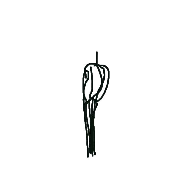

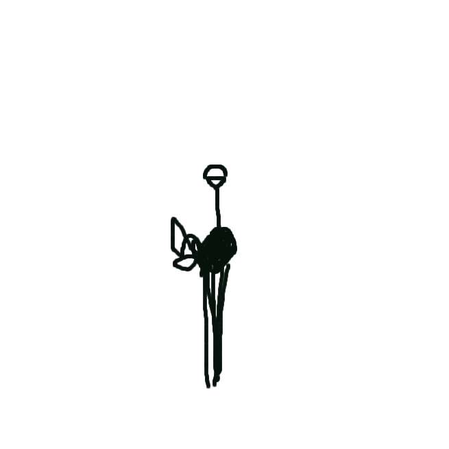

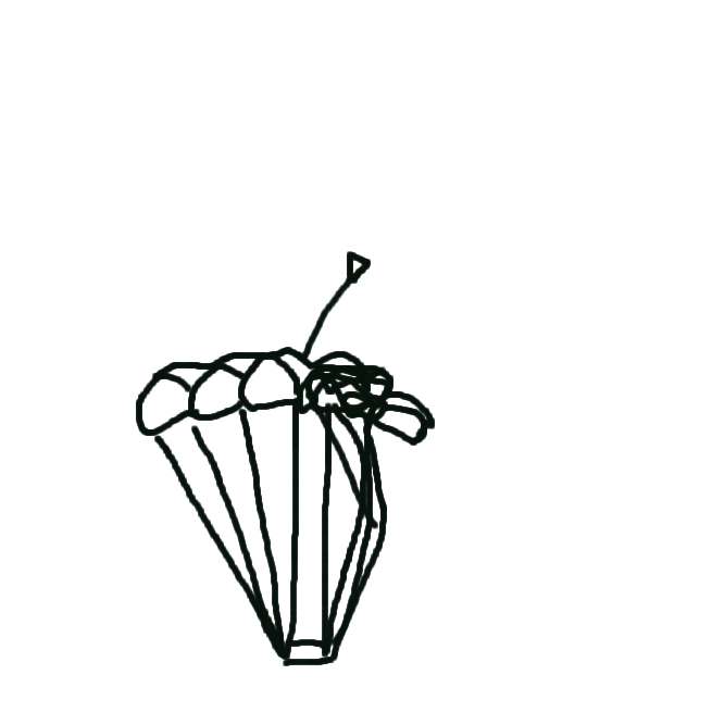

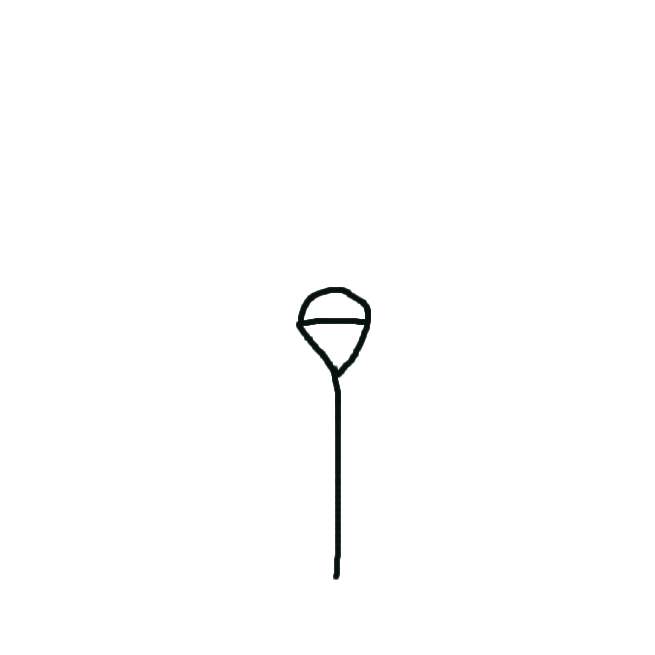

Here are some photos from a malfunction I had. Video is on the same web site.
You may have to photoshop out the background, if the IPA feels the same way about my parachuting discipline that the USPA does.
Malfunction occured in September 2002 in Switzerland.

The first picture looks really nasty! I wanted to ask how you managed to survive that, but then I watched the video and saw the canopy was still opening.
btw; did you just cut the command line or something else, too? If this had happened on a skydive at 3000', would you still cut the line or would you chop?
Since Petur is (presumably) writing for skydivers, differences between skydiving and BASE emergency procedures should probably be pointed out if this picture is used- especially the fact that we always have the option of cutting away and deploying reserve while BASE jumpers have to make do with whatever mess may come out of the container.

...did you just cut the command line
Yes. I just cut the toggle off.
Quote
If I saw this on a skydiving main, I'd go to the reserve.

Thanks for the video and stills Tom!
Even though it's BASE footage, the procedure demonstrated is something I think skydivers should consider below 1 grand.
