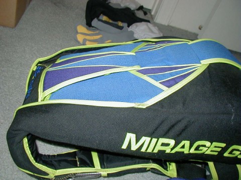

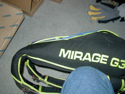

skycat 0 #14 January 12, 2003 Quote Gotta get me a way to pinch down the center. Damn I hate those Vectors and Mirages PM hooknswoop, we have one of each and he has no problem getting them closed off and the reserve being tight and flat rather than bulgie like 90% of the ones that I have seen. As you can see from the picks my reserve top flap is nice and flat, and the tab doesn't bend at all to get into the slot.Fly it like you stole it! Quote Share this post Link to post Share on other sites
