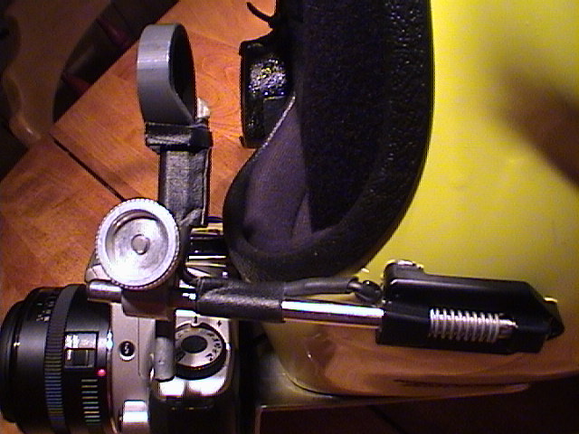

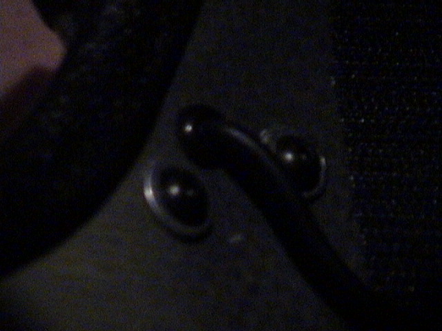

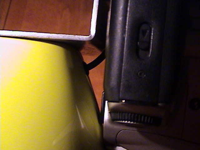

XDV 0 #7 November 5, 2002 I set my Optik with every wire inside (tongue switch and cameye) For the tongue switch I drill behind the still camera in the forehead and the wire get out of the helmet on the right side just at the beginning of the form for the dytter, same for the cameye drill through the D-box and the optik and the wire get out just under the articulated right sight mount. I put grommet on each hole I made to get a cleaner look and also that prevent the wire to get cut by the side of the hole. jump safe Quote Share this post Link to post Share on other sites

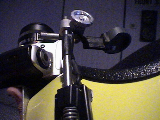

OmriMon 0 #8 November 5, 2002 do u mind posting a picture of ur setup i attached a pic of my setup Quote Share this post Link to post Share on other sites
XDV 0 #9 November 6, 2002 I made those quick picture to give you an idea of what I did on my optik, I bought the grommet at Radio Shack, 15 for 1$ Quote Share this post Link to post Share on other sites
OmriMon 0 #10 November 6, 2002 did u have to cut the cable to get it in the helmet? Quote Share this post Link to post Share on other sites
XDV 0 #11 November 6, 2002 Infortunatly....yes, put I try to make it very clean when I join back the wire, I use soldering and also very small shrink tube for aeck wire and a bigger oneto make a sleeve over them Quote Share this post Link to post Share on other sites
