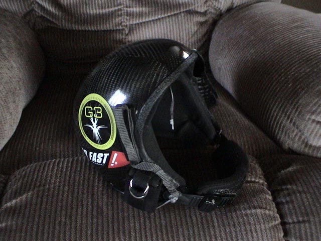

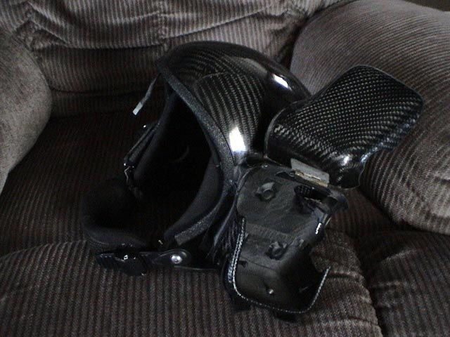

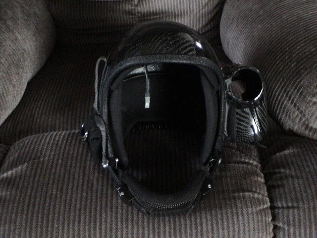

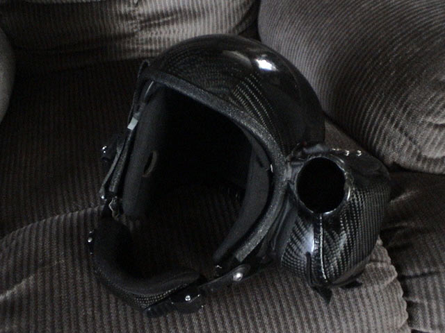

Craig 0 #5 February 5, 2003 Just finished my helmet... Quote Share this post Link to post Share on other sites

deaffreeflyer 0 #8 February 6, 2003 Nice work! Is that camera box - Debox Cookie from Cookie Composites? How secure is it? Will it attach on Optix no problem? I can't see how you made cutaway system on your Mindwarp. Please can you tell me how do it set up etc... and any chance for close-up pix on your cutaway system? Quote Share this post Link to post Share on other sites

Craig 0 #13 February 6, 2003 Quote Nice work! Is that camera box - Debox Cookie from Cookie Composites? How secure is it? Will it attach on Optix no problem? I can't see how you made cutaway system on your Mindwarp. Please can you tell me how do it set up etc... and any chance for close-up pix on your cutaway system? Yes, it is a Cookie D-Box. I am confident it is not going anywhere. I would guess that mounting it on an Optix would be no prob. For my cutaway I used some 3/8" nylon webbing (actually it came from the existing camera strap had to remove it cause it fits the box so closely). I took one end and passed it through the loop in the cotter pin and sewed it down. then took the other end and formed a loop and sewed it and attached some velcro as well. I put some gaffers tape over this part cause I do not think the velcro will hold up as narrow as the webbing is. Quote Share this post Link to post Share on other sites
