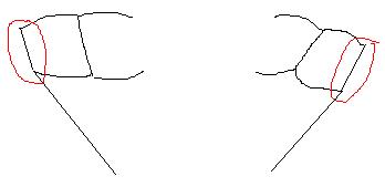

Push 0 #1 July 9, 2003 Ok, this is kind of long, but please bear with me. I have a Triathlon. It was built before they did that update, but the previous owner relined it, so the lineset has been updated. I've recently started jumping it and I'm noticing a built in left turn. It's a fairly slow turn, maybe a degree a second or so. If I wait a long time I will start drifting off heading, and it's just severe enough to require correction on final approach. This is, of course, annoying, since I need to keep the right control line under tension to fly straight. It doesn't seem to be my weight in the harness because moving around in it does nothing (the Triathlon is completely square, planform factor 0). Two riggers checked the length of the lines and found nothing except a 1/4 inch offset in the control lines, which will do nothing anyway because the slack in those lines is much greater than 1/4 inch in full flight, and the canopy is turning in full flight. Finally, I inspected the shape of the wing. Basically, I checked that the stitching on the canopy is symmetrical. Here's what I found. Basically, I start from the center cell and work outwards. So I would take the 3rd and 5th cells and check that all the stitches are the same length. Same with the 2nd and 6th, etc. I didn't check every single seam. I checked the nose and the tail, and they're symmetrical. Then I started checking the ribs. I compared the outermost ribs on the outermost cells (the 1st and 7th). These are the ribs that have no canopy to one of their sides. See my poor excuse for a drawing for more explanation. One of these ribs is about half an inch shorter than the other. The left rib is shorter, so that side would be generating less lift and my weight would effect it more, bringing the left half of the nose of the canopy down and causing a slow left diving turn. The other ribs seem even. My question is, it's a pretty small difference. Could this be what is causing the turn? If so, is there an easy way to fix it without ruining the performance of the airfoil and/or endangering the lineset? I was thinking of tying a knot in the other A line to pull down the right rib until they balance, but I'm not sure what effect that would have on the strength of the line. Do I have to send it to Aerodyne or could a rigger undo the bartack and move the line attachment point? Thanks for reading this far -- Toggle Whippin' Yahoo Skydiving is easy. All you have to do is relax while plummetting at 120 mph from 10,000' with nothing but some nylon and webbing to save you. Quote Share this post Link to post Share on other sites
darkwing 5 #2 July 9, 2003 The critical piece of missing information is how much toggle dies it take to correct the turn? At least in the old days and I suspect now also a manufacturer has a turn tolerance, that is, some specified number of inches of toggle to correct a built-in turn is allowed before any repair action is taken. I can perhaps justify the rib difference as causing the turn, and if it is worth the effort (and my sense with limited information is that it is not), then shortening the other rib is a fairly easy modification. -- Jeff My Skydiving History Quote Share this post Link to post Share on other sites
Push 0 #3 July 9, 2003 I will talk to my rigger tomorrow, maybe have someone more experienced jump that canopy and make the call. Either way, I will let this message board know, it can be educational. As to the toggle input, I need to pull the right toggle maybe half way down the riser. -- Toggle Whippin' Yahoo Skydiving is easy. All you have to do is relax while plummetting at 120 mph from 10,000' with nothing but some nylon and webbing to save you. Quote Share this post Link to post Share on other sites
