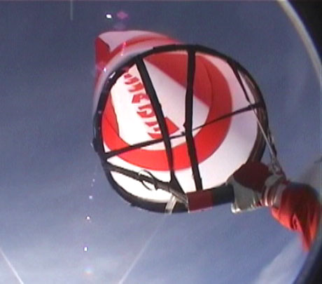

RedITALY 0 #8 September 5, 2002 My sistem is more light... The weigth is very important if you want grip(?) your tube under canopy... But attention! It is a very dangerous manouvre... The tube in www.flyinvillage.it have a 3 rings cutaway sistem and is 65cm. of diameter and long 6.5 mt. Very very light. Peace REDPeace -RED- Quote Share this post Link to post Share on other sites
skreamer 1 #9 September 5, 2002 Where on your site are the tube pics? Quote Share this post Link to post Share on other sites
RedITALY 0 #10 September 5, 2002 HANDLE MODE You can see the ring for cutaway system (ONLY IN FOOT MODE) NO CHAIN but nylon strip (like a briddle) PVC pipe for hand sorry again about my english... REDPeace -RED- Quote Share this post Link to post Share on other sites

RedITALY 0 #12 September 5, 2002 http://www.flyinvillage.it/immagini.it/tubo7.jpg www.flyinvillage.it/immagini.it/tubo7.jpg REDPeace -RED- Quote Share this post Link to post Share on other sites

klingeme 1 #16 September 5, 2002 Post: Where on your site are the tube pics? Here http://www.flyinvillage.it/immagini/tubo7.jpg Mark Klingelhoefer Quote Share this post Link to post Share on other sites
