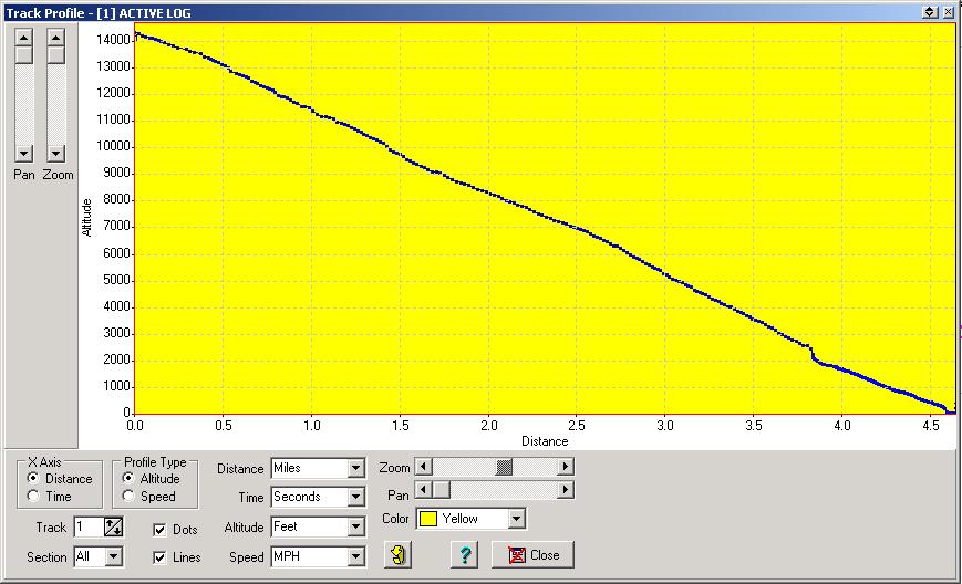

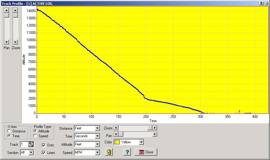

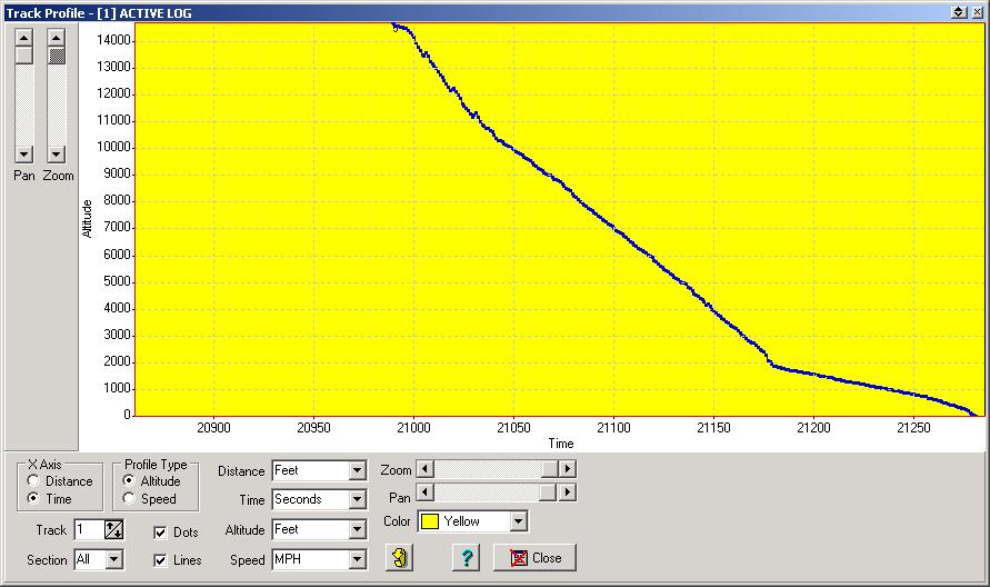

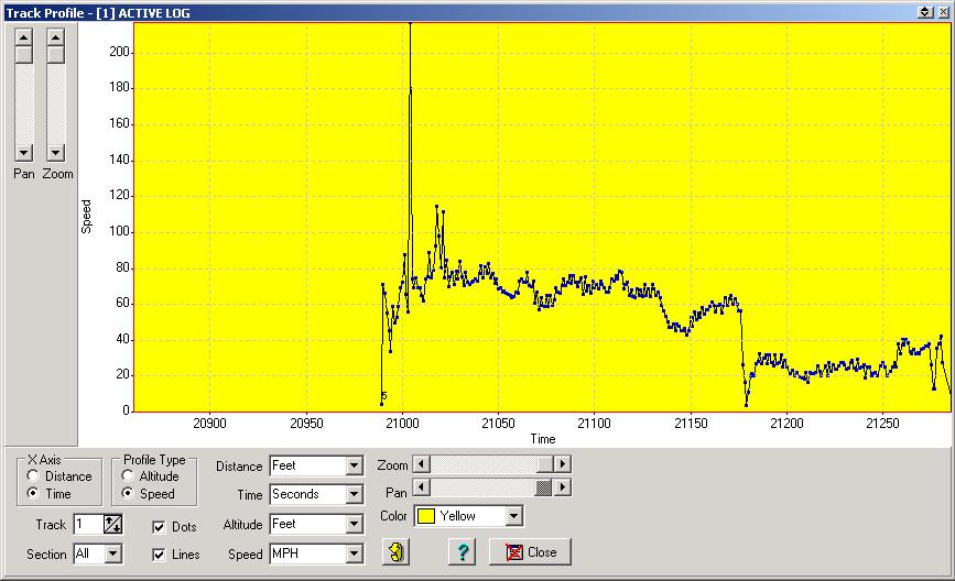

cpoxon 0 #5 July 23, 2002 For those of you who can't (or won't!) install the OziExplorer software, here are some captures of the graphs that are produced and a plot of the paths taken. Note the speed measurements are horizontal, i.e. across the ground. The increases in altitude are visible in AltVsTime2 and AltVsDistance2. Quote Share this post Link to post Share on other sites
