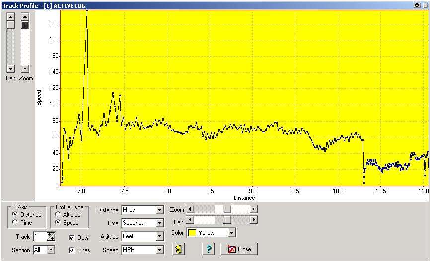

cpoxon 0 #10 February 12, 2003 Quote Scott, the most techie GPS guys I know in this forum are Craig Poxon and maybe Fordy. I am sure one of them will pipe up in a minute I was going to but he poo-pooed my "squiggly lines" so now I'm sulking :-P Was having a brief conversation with Hooknswoop about this the other day. I've had some good results from OziExplorer which produces a nice track profile, but it seems that the latest freebie version doesn't have that function available? I'm unable to test this as I don't want to lose the version I've got installed if this is true and don't have a spare machine at the moment. I tried playing with the 3D version for a visualisation but with no success. I've emailed the authors to see what they know. I'm sure I posted something about this before when Yuri supplied me with some of his data before I had my own Skyflyer, but I've not been able to find it?! I had attached several pictures of combinations of the track profile. Their production required a little bit of tweaking; manually determing the start and the end of the freefall to trim the graph left and right with the scroll bars, setting a nice scale, as well as vertically. I've attached a couple of graphs generated from Yuri's data which should satisfy Scott/Lou (I thought he was really Lou Diamond Phillips! :-P) where the speeds and distances covered are apparent. Both measurements are for the horizontal vector. A ProTrack download will give you a graph of both of the vertical vectors (I think OziExplorer will only do this for distance not speed). Quote Share this post Link to post Share on other sites
